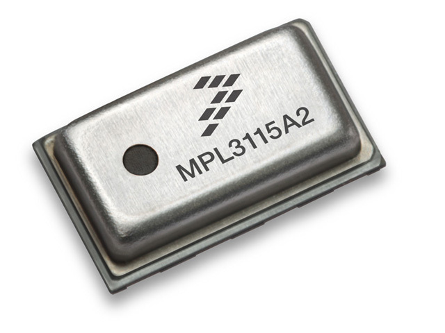

In terms of the CC3D, do you know if yours has a built in barometer as this is something that is fairly important when it comes to altitude hold. Without it the altitude information only comes from GPS which is not very accurate (in terms of cm accuracy anyways). However the only extra thing you will need to get for the CC3D is a GPS/Compass module. The openppilot/CC3D wiki talks about how to get this all setup so you can use the features like RTL etc…

Wow! that’s service :smiley: Thanks for your swift reply. Could you tell me how to determine if the CC3D I purchased has a barometer? Also could you tell me If I use the Quanum/Cheerson TX do I need a dedicated receiver or will it bind with any automatically? If you have a suggestion I’d be grateful I love building but I would sooner build it properly first time and choose to upgrade, rather than waste cash buying unsuitable parts or things I don’t need! Is there any info on running a gimbal from the CC3D. I like the fact that I can use the rotary pot on the Cheerson to operate the gimbal Again thankyou for your kind assistance 63 and still enjoy learning. I surely will post some photo’s of the build
Most CC3D boards don’t have a pressure sensor, but if you look at the actual board you should see something that looks like this:
Otherwise you should just check the specs of where you purchased your cc3d.

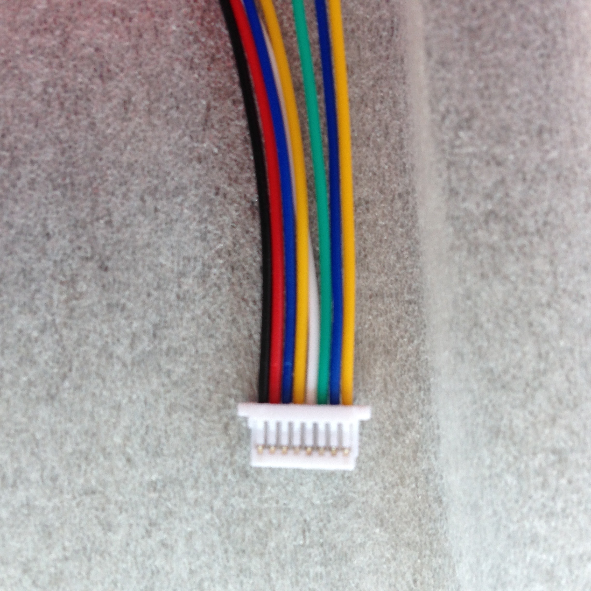

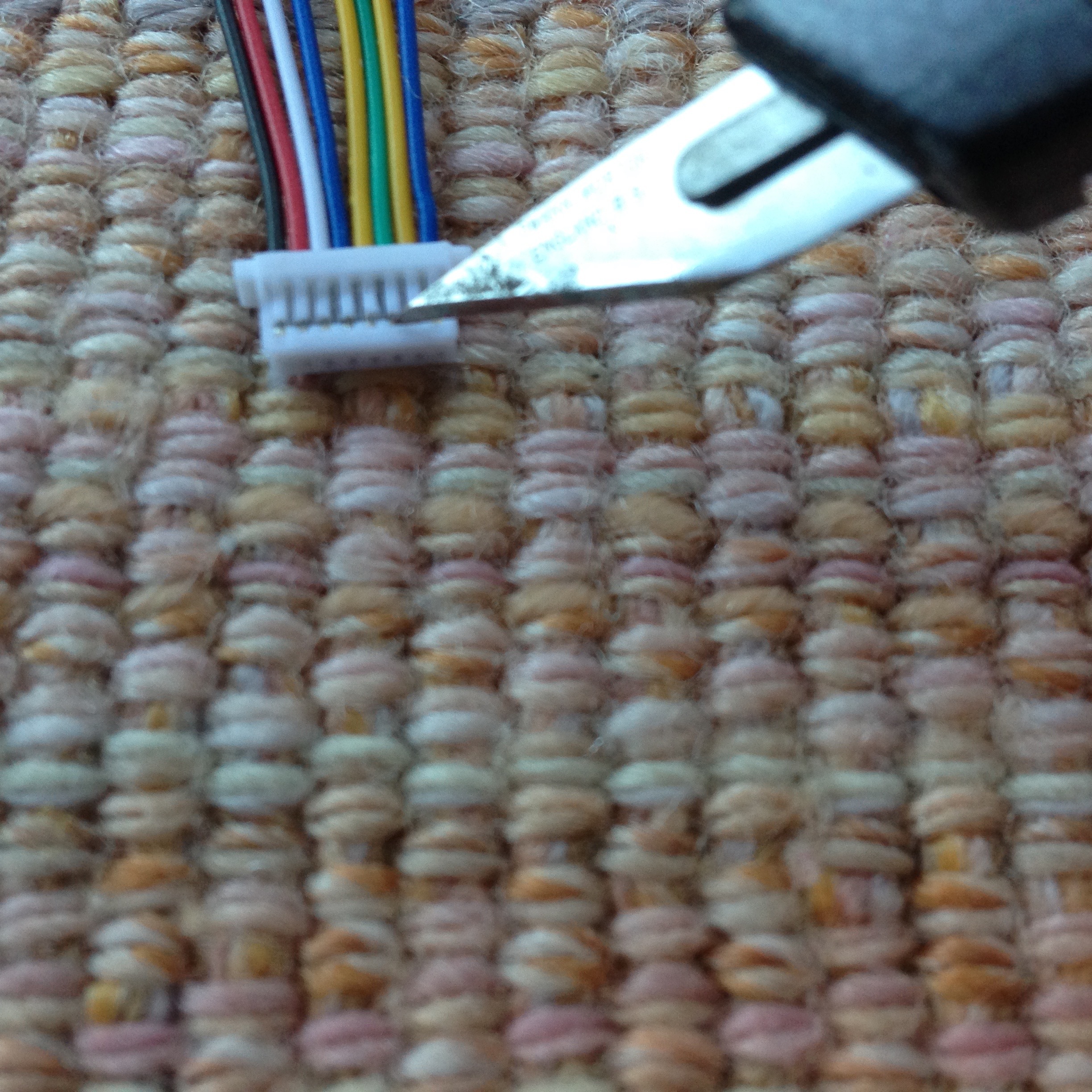

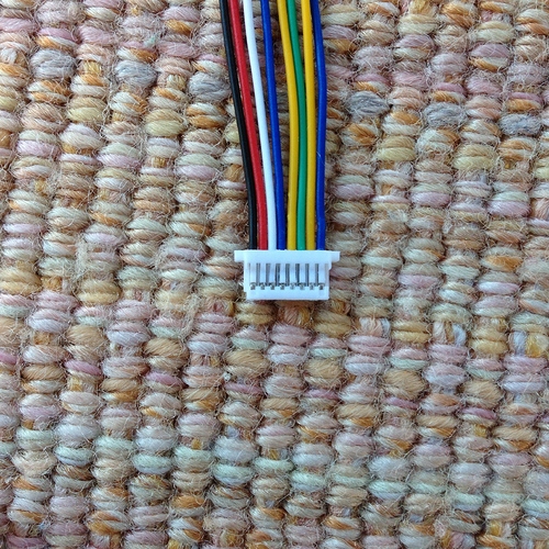

I Just thought that this may prove to be of interest to someone? I have recently purchased 2 CC3D flight control boards through Ebay I noticed that the wiring on the plug that links the flight control board to the receiver differed not just in colour coding but in the sequence. Most importantly the white signal wire from terminal 3 was actually wired into terminal 5 see pics. I am not an electronics engineer but I have read some cases of Chinese CC3D boards not working or failing could this be the reason?? I guess I have purchased ( in-advertantly) a knock off version so anyway I contacted my supplier and sure enough the picture they sent me matched all the others I have seen on forums. Now I understand that colour may not be important, but relative pin location is, The 3 way with Neg/Pos/Signal should supply terminal 1 2 and 3 in that order, however on the one I was supplied with - + sig were 1 2 and 5.
I must stress I’m no electronics engineer so I cannot accept any responsibility for loss damage or personal injury however I think the lesson is never take it for granted that someone else did their job correctly. I haven’t tried this yet so wish me luck and if it helps some one to avoid trashing a board then I’m happy. It was a simple matter to pull the offending wires from the plug and re-arrange them see photo’s
Thanks for sharing that :thumbsup: , its a great tip and an relatively easy solution (all be it abit fiddly). It seems that some manufacturers just try to make the cheapest version which can be great for our hobby opening it up to more people but some of them have the wrong cable layouts (like you have experienced) as I dont think many of them bother to ever check this :boom:.
