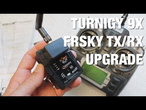

However what is the main reason for you upgrading? Is it because you want better range, or you just like the screen and extra features of the taranis? As a cheaper option would be to just upgrade the R/C transmitter module on your turnigy 9x, to a FRsky one. But then you still need to use your current radio with small screen. Either way its still not a bad idea to use teh taranis X9D, but just letting you know there is another option :smile:
