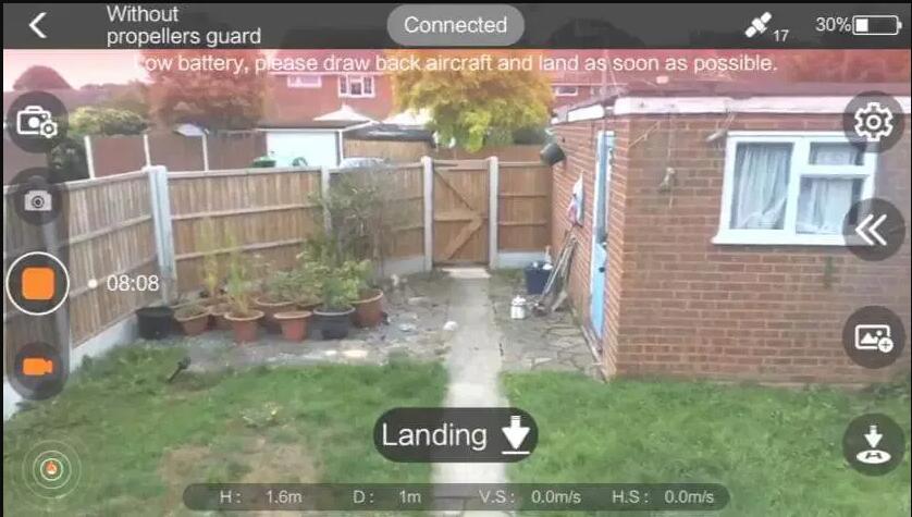

At 30% low battery warning after 8 mins

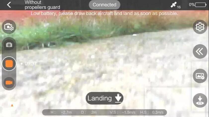

And finally landed at 9 mins 37 seconds, but – the 7 seconds before take off at the start gives
A flight time of 9 mins 30 seconds.
