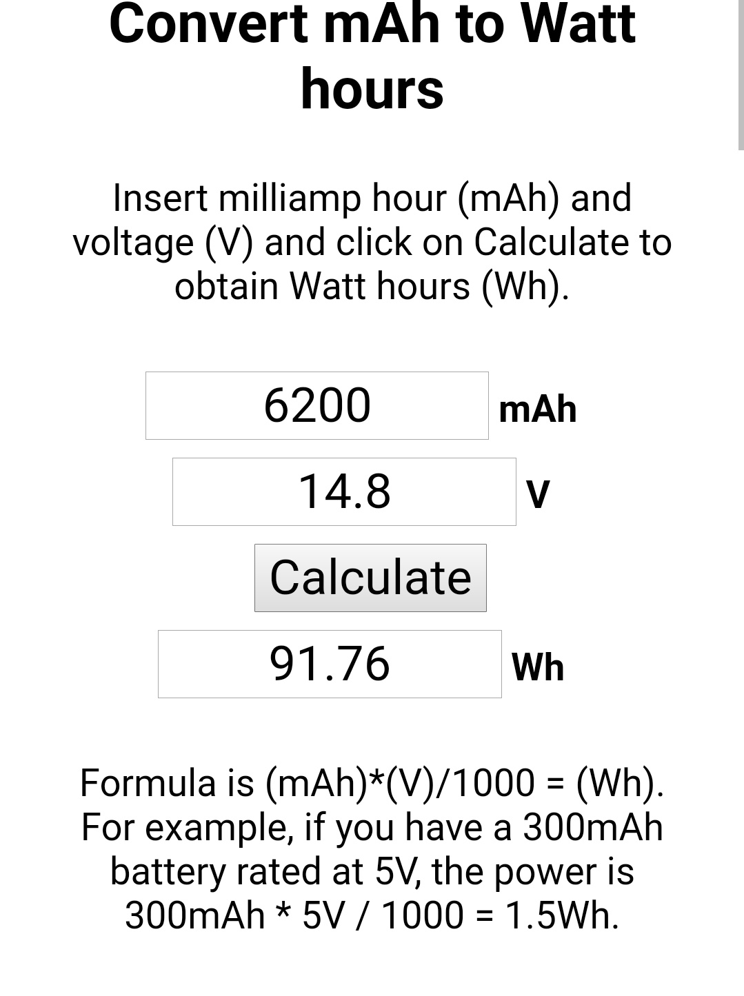

Spec -
Capacity: 6200mAh
Voltage: 4S1P / 4 Cell / 14.8V
Discharge: 40C Constant / 50C Burst
Weight: 589g (including wire, plug & case)
Dimensions: 158x46x41mm
Balance Plug: JST-XH
Discharge Plug: HXT4mm
They say this -
Batteries, spare/loose, including lithium metal or lithium ion cells or batteries, for portable electronic devices must be carried in carry-on baggage only. For lithium metal batteries the lithium metal content must not exceed 2 g and for lithium ion batteries the Watt-hour rating must not exceed 100 Wh. Articles which have the primary purpose as a power source, e.g. power banks are considered as spare batteries. These batteries must be individually protected to prevent short circuits. Each person is limited to a maximum of 20 spare batteries.
edit - According to this calculation, does it mean I can take it?

Each airlines company is implementing those general rules that are similar for most of them. Just remember to check carefull and cross check with them. You already checked the limiting Watt factor and the condition on which you have to put your battery:
  • cover the electrical pin
  • put each battery separately in a LiPo bag
  • some suggest also to have them at their storage voltage status

Exactly you should read the regulation about the flight company but usually is max 100W to carry on.
