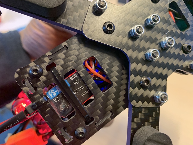

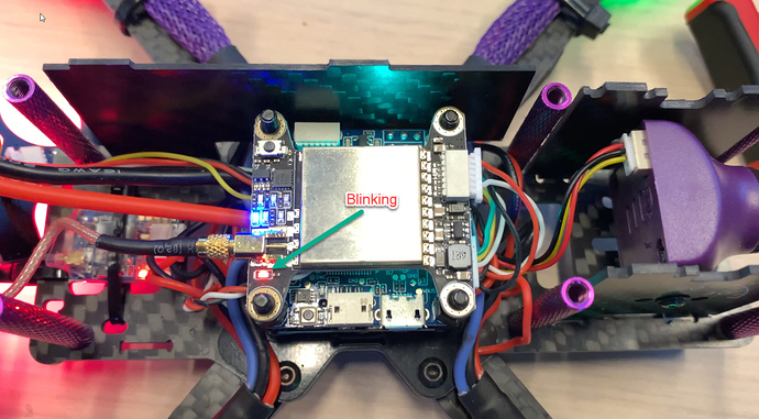

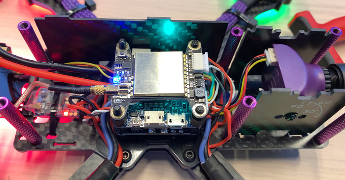

Otherwise can you send a photo clearly showing how your reciever is connected to your flight controller and let us k is if you see any LED flashing on your reciever to confirm it is getting power

In the attachment, you will find the information that you requested.

The middle picture the one with the “blinking” red led is your VTX
The FS-I6X is your RX
