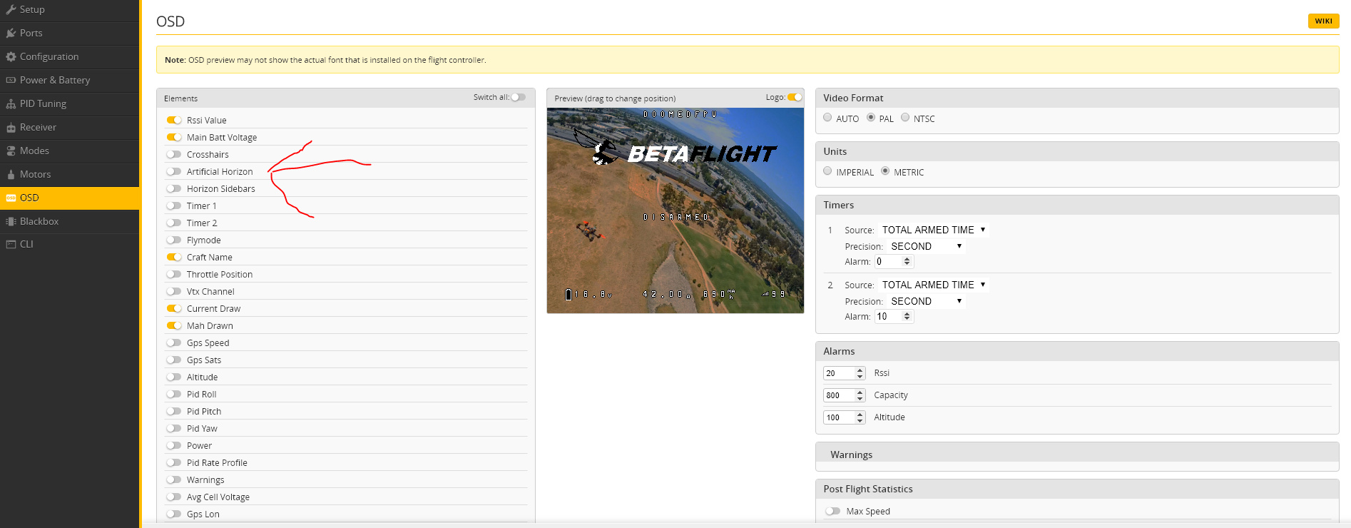

I am flying the Vortex 250 and I am using the FatShark goggles. On screen display has a line in the middle of screen and a square box above the middle line. I want to get the box and line removed. I have gone into OSDisplays and have tried changing settings. No matter what I change I still have the line and box. Any help would be greatly appreciated.

Have you tried this toggle switch?
or try from the CLI
set osd_ah_sbar = 200
set osd_ah_pos = 200
Thank you very much for the help. I think you are right. I have to fix it in BetaFlight. Thank you again I appreciate it.
