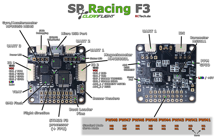

One other thing you might want to double check is that the receiver is actualy connected to the correct port on your SP3 Flight controller as the PPM connector should go to IO 1.

Yeah that was the issue, just had to plug it in correctly… Thanks!
