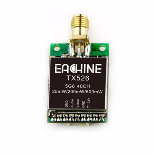

Attach a heatsink to Eachine ETX526?
Hello,
The Tx gets abit hot when using so…
Can anyone tell me if I’m going to do this correct?

Its normal for a VTX to get warm.
The air flow of a quad in flight will keep it cool.
Setting it to a lower power output will help too… 25mW or 200mW
You are saying:
If it does not hurt when touching it, it is okay…
Maybe show us a picture on how you mounted your VTX so we can comment on that.
Also mounting the VTX, so it presses against the Carbon fibre plate, will help it stay cool :sunglasses:
Also check your Antenna. If it is very damaged, replace it.
