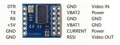

I cant recall off hand which firmware is on the batch we have, but I suggest you use scarab-OSD firmware on it
Here is the pinout if you or anyone needs it (Its also on our product page)
Also I dont have exact specs for power consumption either (just too many products to keep up to date with recently, the designed has not even provided the details!), but I know it uses the AB7456 chip instead of MAX7456 which is considerably more efficient (much lower current) and also more resilient to voltage spikes etc…
