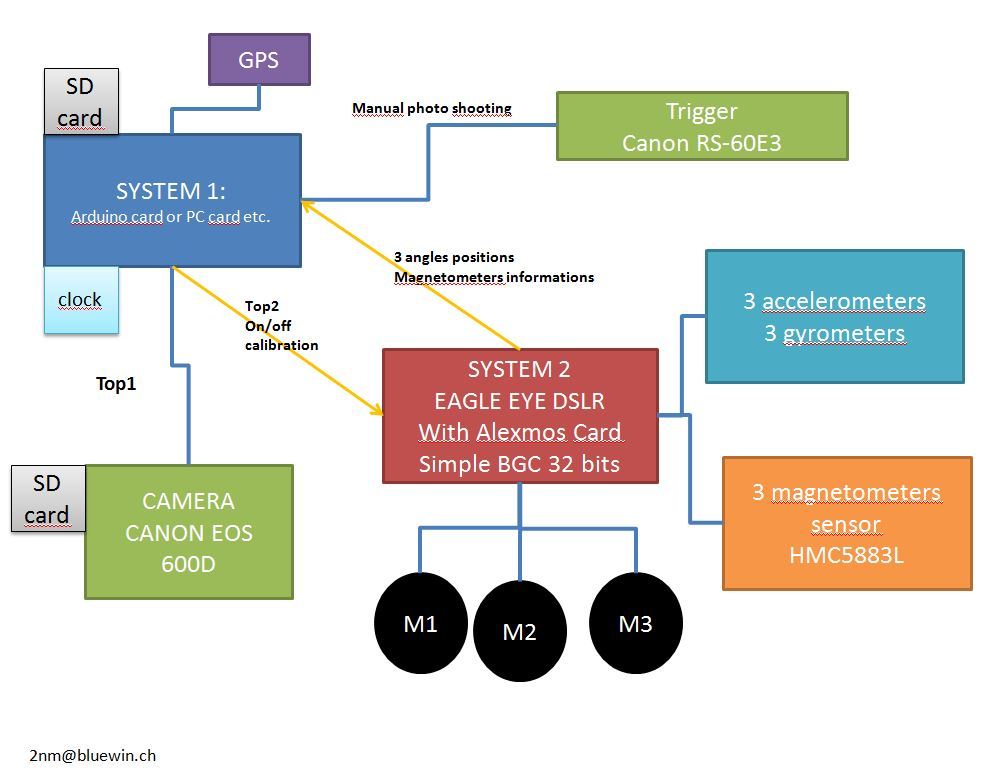

if I understand in the « EAGLE EYE DSLR BL Aerial Gimbal (32BitsController) » there is a « 3-axis 32bit AlexMos controller including IMU sensor » which is a BaseCam SimpleBGC 32-bit.
It is impossible to connect a GPS chip to the BaseCam SimpleBGC 32-bit and it is impossible to modify programmation code.
Question: Is it possible to connect an internal clock with the microcontroller “BaseCamSimpleBGC 32-bit”? (the clock need to be very accurate hours, seconds and tenth of a seconds have to begiven).
I want to take picture and each picutre has to be georefereced. I have the
idea to install an another system GPS with card in paralel to the
AlexMos controller. The GPS is not connected to the AlexMos controller
system. To sum up there will be the electronical system of the gimbal
with the AlexMos controller, and an another system, independant which
contains GPS.
What complete GPS system do you adice me to buy? taking into account that
For this school project, for each picture, the GPS position, altitude and the time have to be recorded.
For thisproject i have to answer CDCF (about likewishlist): pilot cantakepicturewith the remote control of the canon EOS 600 D when he wants.
But beforetkake-off I want enter the parameters and then, during the flight, with the help of GPS the system takes automatically pictures every X seconds depending the evolutions speed of the airplane (speed is not constant during all the flight), the altitude, variousaccelerations ( accordingparametersenteredbefore take-off).
Best regards
And thank you for your time
there are 2 options.
1 - if you are happy to program arduino you can go down that route and connect a Ublox M8N GPS module to your arduino along with a IR camera trigger and program it to record the GPS position, each time it takes a photo.
2- Use an ardupilot mega flight controller, with the same GPS, and camera trigger and set it up to take a photo, this will not require any programming, just use the included software to setup a photo mission.

Hello and thank you for your answers.
here there are 3 pictures of the system i want to construct. Can you help me to answer these last questions (in picture3)?
