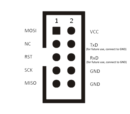

I would like to upgrade my Turnigy Tgy-i6 radio to 10 channels (instead of 6). I have USBasp and I connected like on the picture. The windows do not recognize the port and i cannot upgrade. What is wrong?thank you
pinout_usbasp-1
Sounds like either you don’t have the correct drivers installed for your usb asp device…
Or (less likely) the usbasp device you have is faulty.
First I suggest try to get your pc to recognise the usbasp without anything else connected to it. If that works, but doesn’t when you connect the turnigy then double check your connections
