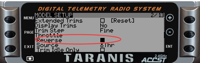

I have a Taranis radio that has a throttle warning every time we turn it on even though the throttle is all the way down. I have also performed the stick calibration but still get the warning message whenever I turn on my taranis. Is there anything I can do about this as its rather annoying and would like to get my quadcopter built.
Hi
The most common cause for this warning is that the trhottle has been reversed. Please check the setting in the model setup menu of your taranis and change the value and you should see the warning stop whenever you power on your radio
