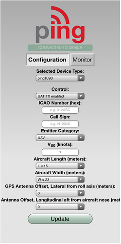

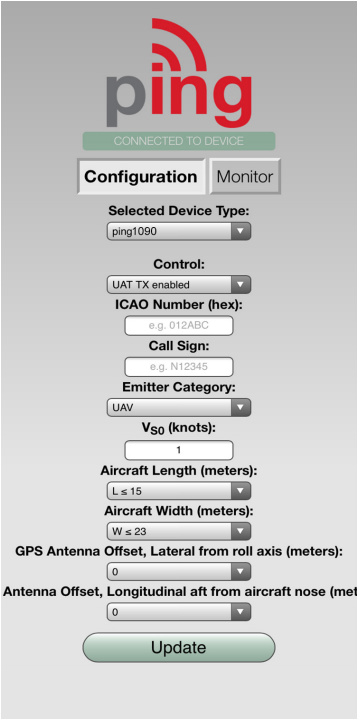

Hi, when using it with a pixhawk it will only send local aircrafts position back to the pixhawk. The ADS-B transmitter data is captured via the onboard GPS/Sensors on the ping 1090i.
That said, if it is not transmitting any data, have you followed the setup guide
Particularly the control selection, where you have 3 options:
Before it will transmit you also need a valid ICAO number (converted to 8 digit hexadecimal) and callsign
