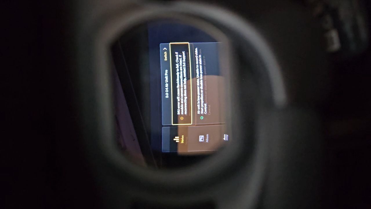

It says it has a imu error when i connect to goggles and it doesn’t give any feed just a black screen
Ive connected to goggles and controller and ive updated the software to the latest on the o4 pro

I think the IMU error is probably related to the low power message stated below the error.
Is the VTX/drone getting sufficient power?
If that is okay, are you running the same FW on both goggles and airunit? Sometimes you get odd errors relating to a mismatch in firmware between the two physical pieces of hardware.
If those don’t sort out the issue, let me know and we can investigate further.
