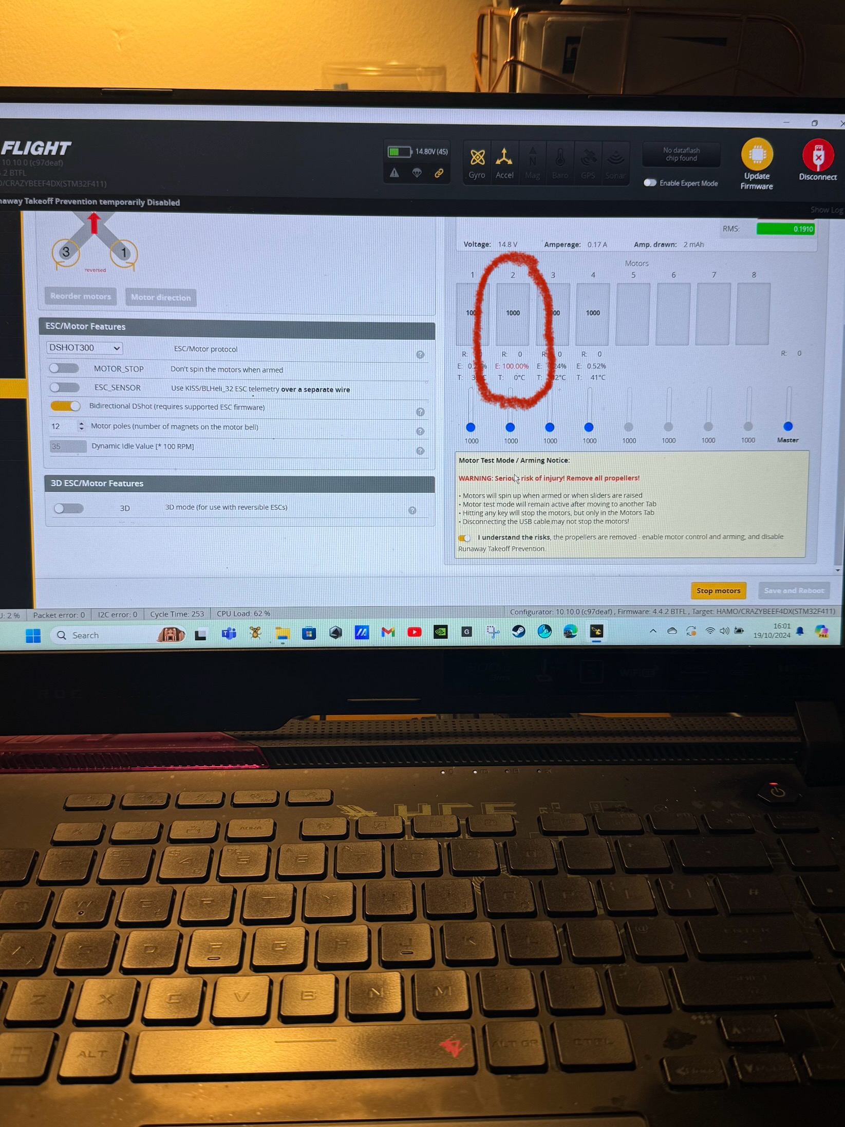

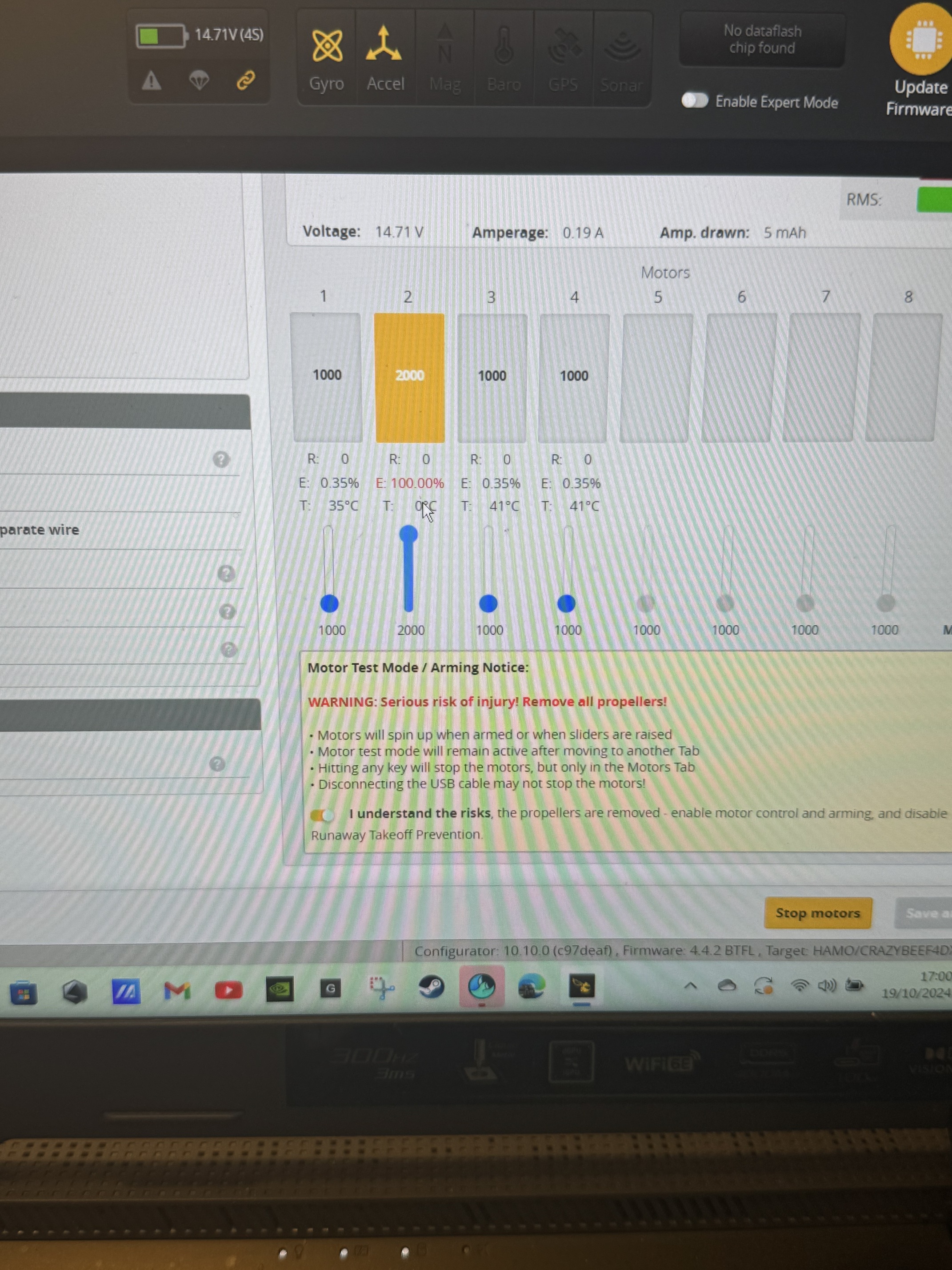

I’ve just opened up the box for the crux35 that I bought from you and plugged it in to betaflight to set turtle mode and the buzzer.
The drone will not arm and on betaflight it’s saying the front right motor isn’t working.
Betaflight showed me the problem
Sorry to hear about this.
Its great to see that you have tried to test thee motors via the betaflight motors test GUI, which would suggest that there is either an issue on the ESC itself, or with the FC/ESC config.
Can I ask if you have tried to update any firmware on the FC/ESC? and can you also just manualy double check the 3 motor wires are connected properly to the FC?
I will then pass this info back to Happymodel to offer their suggestions (either a replacement FC, or a specific firmware setting to change/check)

Having had a look at the screenshot, it would seem that the firmware flash has failed on the motor #2? Have you tried to reflash firmware onto that as I believe this will solve the issue.
Otherwise if you do not wish to test that you can return it back for us to check, if we find there is a hardware fault then we can get this replaced/refunded for you as per our terms, but if its a firmware/config issue then this would not be considered faulty since these items all run third party open source firmware not controlled by ourselves or the manufacturer. But either way we should be able to get the issue resolved for you, in the case of a config/firmware issue depending on the actual issue and time to resolve we may need to charge a service fee for this but will let you know before hand so you can decide to proceed with this or not. Something like an ESC reflash we would not charge for as its a 5 minute job.
