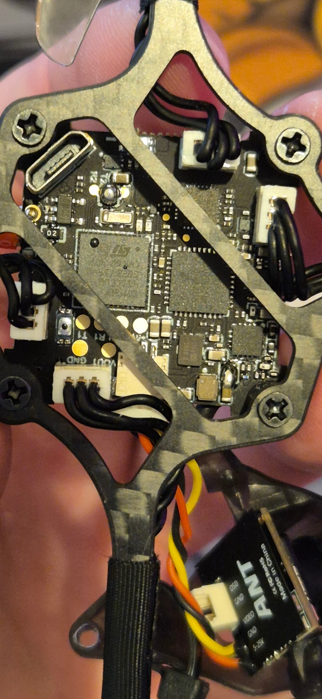

that what esc-configurator shows
also don’t see any MOSFET to be dead or so

so i already post pics but can add them again
i dont see any damage on pics and dont really know what i can do more as i dont have multimeter.

it looks like the esc maybe bad , one thing you can do is go to betaflight , motors tab and specifically for the motor 4 put the slider to 100% , this should overcome any low start power issues that maybe occuring (if it was a software settings issue on the esc) .
If the motor still does not spin then the last final check to do is to switch one of the motors that is working with the one that isnt working , if that “new” motor does not spin then we can say conclusively that the esc is bad.
BUT please double check with the unmanned rep before you do this troubleshooting as they are more qualified than some random nobody on the internet
Thanks for helping out @geonoble01gn and @kyleireland, really appreciate that! As a gesture of goodwill and a small thanks, please PM me your store email address and I can get some store credit added for you!
@mikusiekk Thanks for checking these things, it does look like the FC is faulty or at least the Mosfet on the one ESC is, so I can offer the following solutions:
