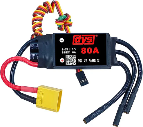

ESC doesn’t work with RX, connected with and without external RX battery. Beeps constantly but does not recognise top throttle position or any throttle input.
tried same set up with 30a ESC which works without issue.

First, a couple of quick safety notes (props off, please!) and then a focused checklist that usually fixes “constant beeping / no throttle” on fixed-wing ESCs:
1) Confirm the signal type
This ESC expects a standard PWM throttle signal direct from the receiver’s CH3/Throttle port. If you’re going via a flight controller or using SBUS/PPM, please plug the ESC’s signal lead straight into the receiver’s throttle channel to test.
2) Throttle end-point & direction
A reversed or out-of-range throttle often causes continuous beeping (ESC thinks throttle is “high”). On your radio:
• Make sure throttle isn’t reversed.
• Temporarily widen throttle endpoints (e.g., 110%/110%) to guarantee the ESC “sees” full range. Then try a fresh calibration (next step).
3) Throttle calibration (DYS method)
• TX on, throttle stick full HIGH.
• Connect the flight battery to the ESC; wait for the calibration beeps sequence.
• Move throttle to LOW immediately when the tones finish, wait for confirmation beeps.
• Power-cycle and test.
4) Power & wiring sanity checks
• This ESC has a 5 V/6 A SBEC designed to power the RX/servos — so no external RX battery is required. Please try with the ESC BEC only (and also once with the external pack removed) and confirm the receiver powers up solidly.
• Verify the signal wire orientation at the receiver (signal to “S”, red to “+”, black/brown to “–”).
• If available, try a different RX or a short servo lead to rule out a cable fault.
5) A quick A/B test
You already tested a 30 A ESC successfully — great data. If the above steps don’t resolve it, that strengthens the likelihood of an ESC fault.
