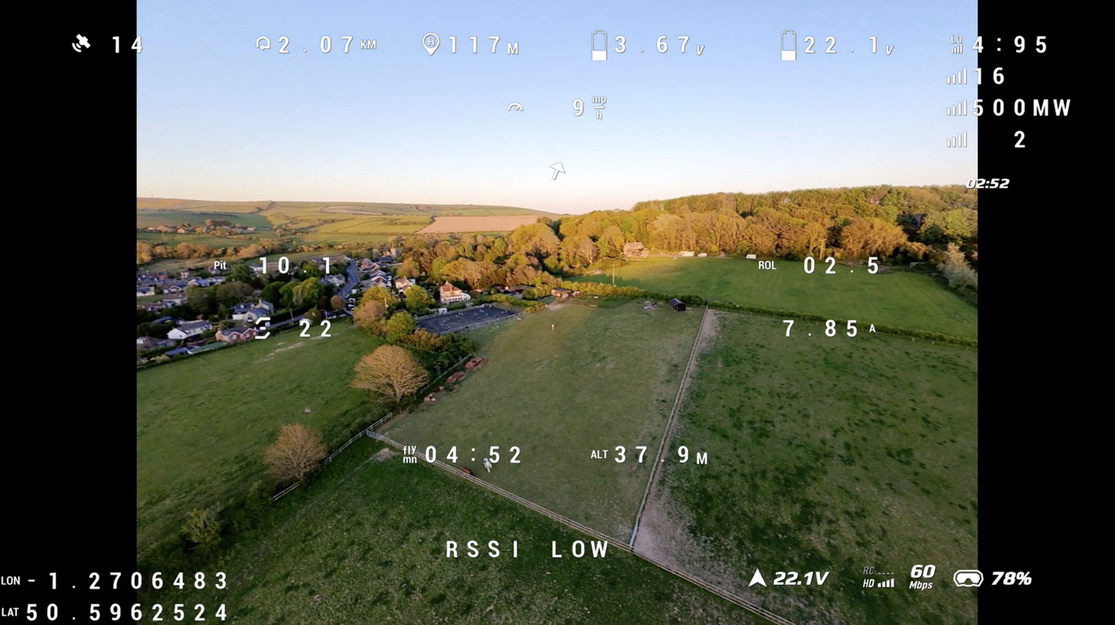

I recently purchased the Axis Flying Manta 5 SE quadcopter from you, and I’m experiencing issues with the ELRS receiver that came pre-installed.
I’m using a Radiomaster Boxer with the ELRS 2.4GHz, running at a 100Hz packet rate and a telemetry ratio of 1:4, max power 1W Both the transmitter and receiver have been updated to the same version of ELRS firmware using the ExpressLRS Configurator.
The problem I’m encountering is that the receiver appears to be losing signal randomly, even at relatively short distances. I’m using dynamic power on the transmitter, but the output power is not increasing in time to maintain the link. I’ve observed it dropping from 1W to 50mW without reason, leading to complete signal loss.
For context, I’ve used the same transmitter with other ELRS receivers on my fixed-wing aircraft with no issues — I typically achieve stable control out to around 5 miles.
Additionally, while flashing the receiver, I used the “AxisFlying Thor 2.4GHz RX” target in the ExpressLRS Configurator, assuming it’s correct based on available information. However, I haven’t been able to find any clear documentation confirming the exact model of the receiver that comes with the Manta 5 SE. It’s possible that this could be contributing to the communication issues if it’s not the appropriate firmware target.
To demonstrate the issue, I’ve uploaded a video showing the power scaling and inconsistent signal behaviour:

Hi there, I’ve switched out the stock receiver with my Happy Model EP 1 and everything is working flawlessly with dynamic power enabled, it’s rarely going over 25mw transmission power.
After closer inspection of the receiver shipped with the Manta 5 SE, it’s got Cyclone written on it. Could you please clarify if the correct firmware target is the Axis Thor 2.4Ghz or something else… it very much looks like the Cyclone Nano 2400 RX receiver.
Update: I just flashed it with the Beta FPV 2.4Ghz Nano RX target and it’s working fine now, full link quality and RSSI. You might want to add to the online product description the correct receiver that it’s shipped with…
Thank you very much for letting us know, Axis Flying should be open again now after National Labour day so I will check with them again and get this updated.

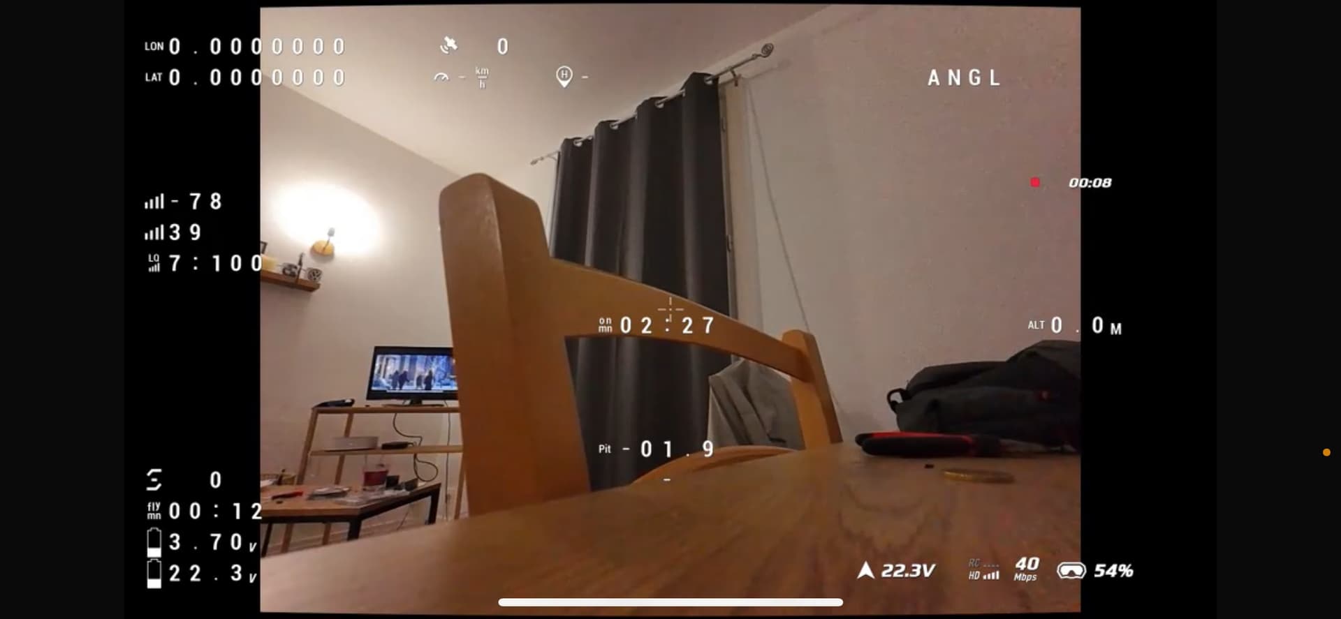

Good evening, I’ve been trying to solve this problem for almost a month now and I still haven’t found a solution.
To give you some context, I bought a kit (a Manta 5 SE drone, N3 goggles, and a Commando 8 Lite radio). After some time, I decided to fly it for the first time. The day I did was a disaster. When I got up about 20 meters and then flew another 20 meters away, the “RX LOSS” message appeared on the goggles. I didn’t have time to react, and the drone crashed to the ground (while I watched it fall through the goggles, with no response to the radio).
Initially, I thought the RX antenna was damaged or something, so I replaced it (just the antenna to check), but nothing changed. Then I thought the radio was obsolete, so I bought an external antenna for that radio, but it’s still the same. I can’t get any signal. I kept trying from my house (like in the video), and when I fly a few meters away with the radio, the signal drops (no more than 10 meters).
Can anyone tell me what the problem is? Could that be it? Some people tell me the radio’s power output, but according to the iLight website, it comes pre-configured at 100mW, which should allow me to fly farther than I’m currently able to. I would greatly appreciate any guidance.
In the photo I am less than 10 meters away.
