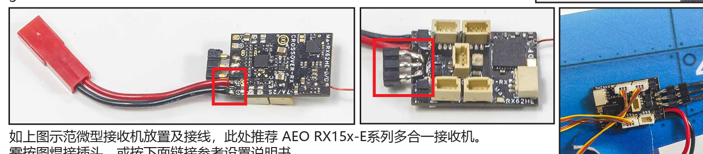

I bought the NewBeeDrone 40C 3.8V 1S ph 2.0 batteries as they were promoted with the product. The connector on the mini receiver is for a JST and they recommend a 2s 550mAH. Can you help please?
Hi David good day,
Thanks for reaching out to us!
I had a look at the mini RX you mentioned, I see it has solder pads on the rear to connect up any power lead you want, I would daisy chain two PH2 connectors in series to the RX so you can use the nitro Nectars you picked up.
You could cut and solder up an adaptor from these if you don’t have on hand:
If you don’t have heatshrink:
I see the recommended battery for this model is 150-250mah, just make sure your CG is correct if you use the heavier Nectar packs and remember it will need to fly a bit quicker because of the added weight.
