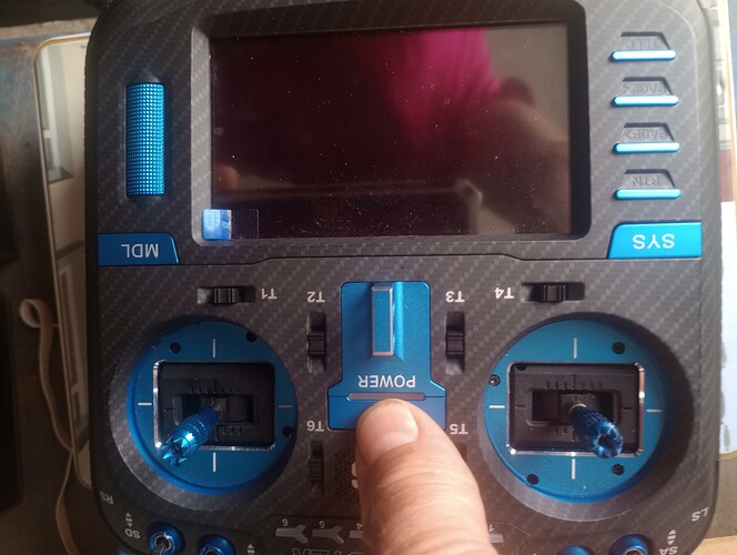

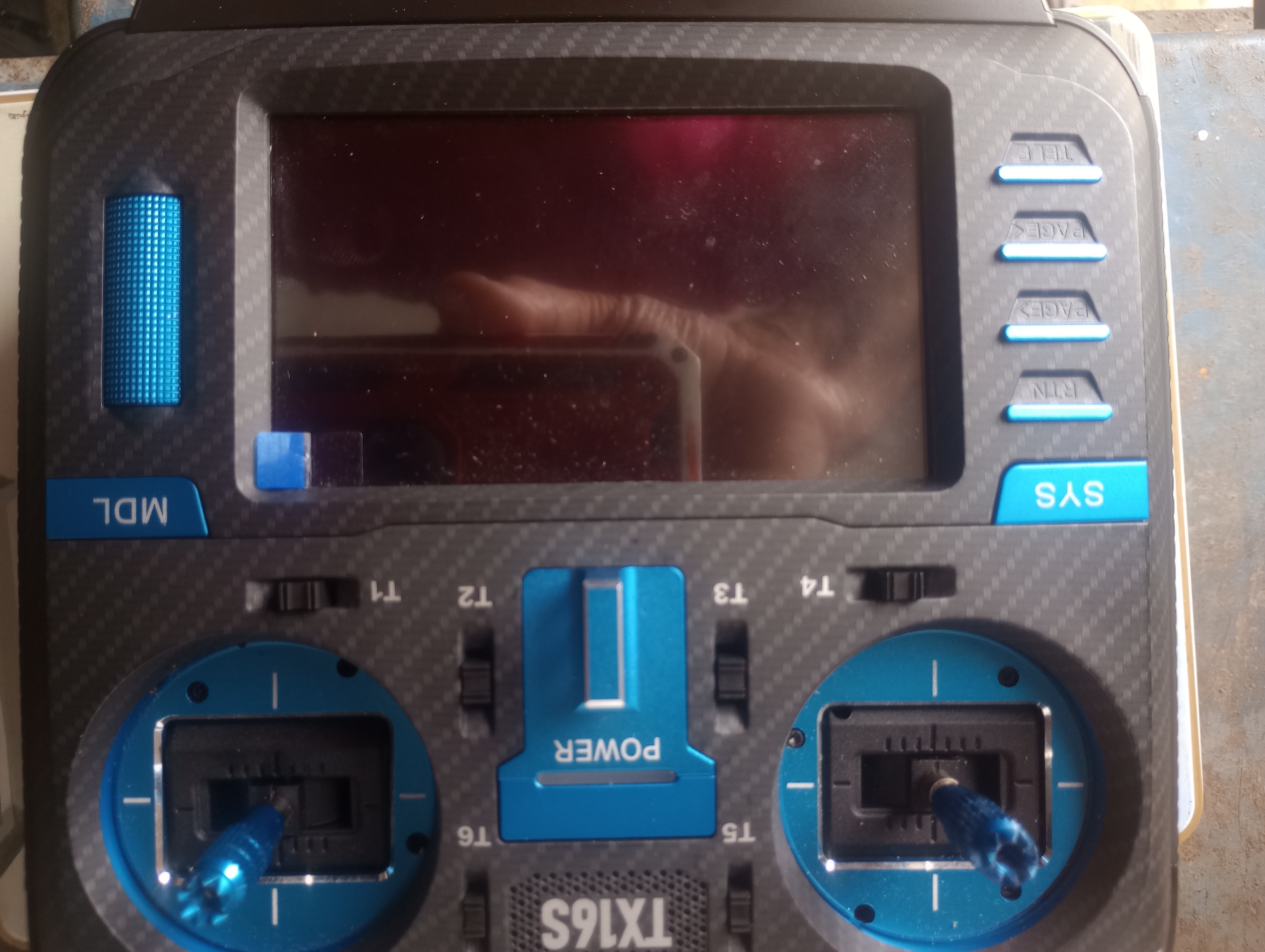

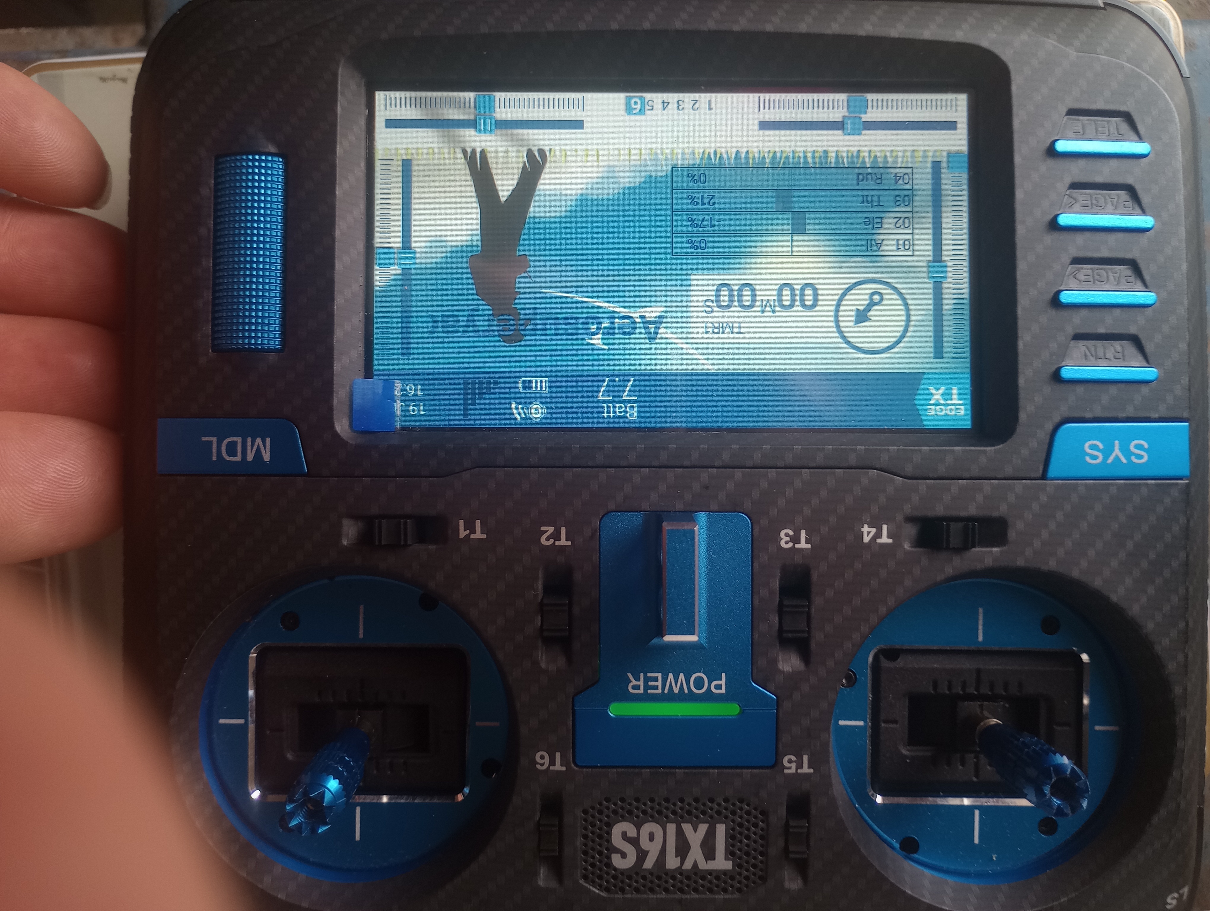

Tx powers off by itself and can be replicated by a tap on the casing side. Battrey has to be removed and reinserted to get Tx to power up.

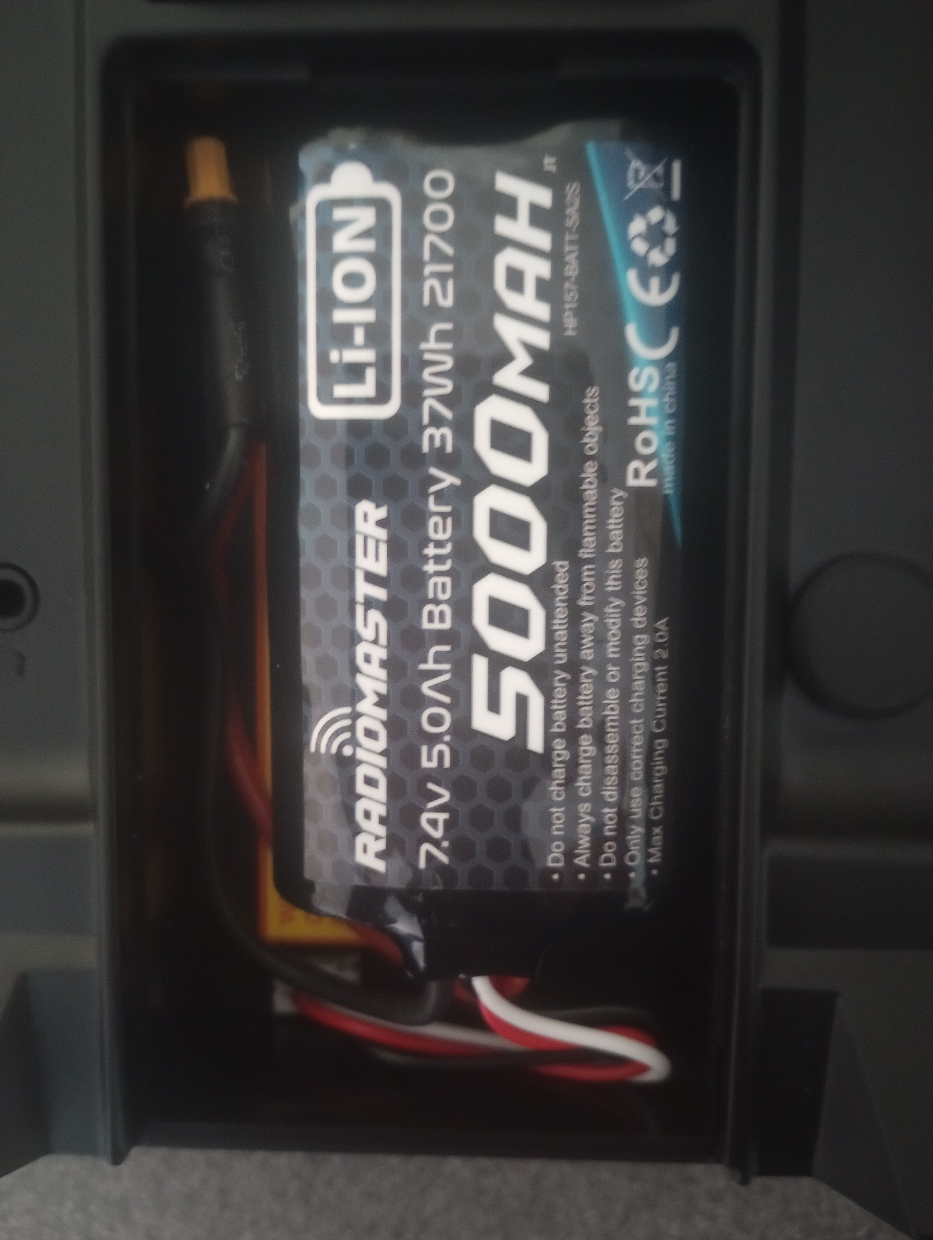

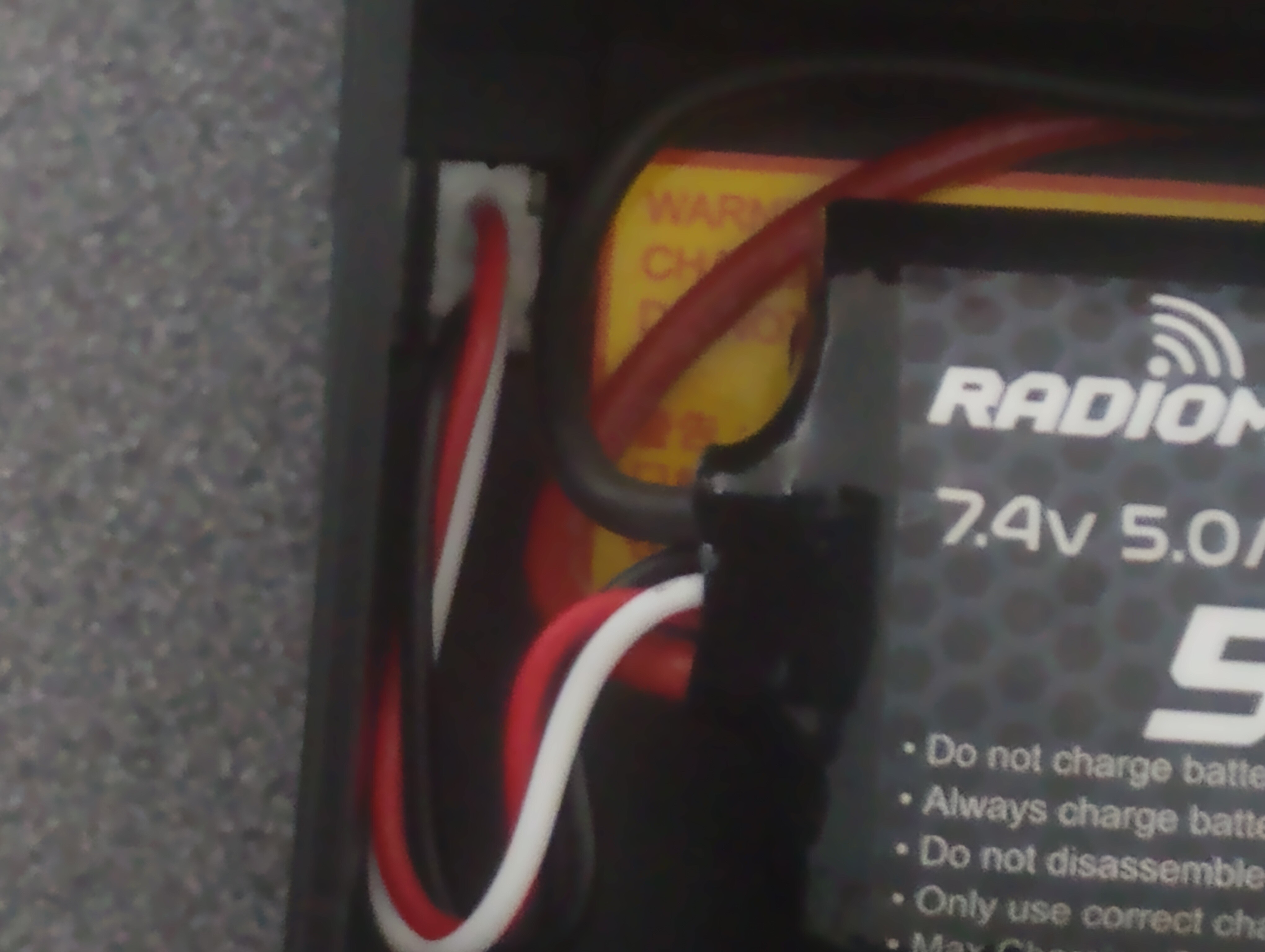

Have ensured battery is securely plugged into the unit.

| Battery tray & contacts | Remove the rear cover and make sure both 18650 cells sit tight. If they can move, add a 1 mm foam pad to the door to keep them pressed forward. Also double check your cells have the protruding head, as if the are flat of both sides they may not fit properly, as per the official RM 18650 cells | Even a hairline gap can break power when the case is tapped. |

Can you also please confirm what batteries you are using with your radio, are they the official Radiomaster 18650 cells?

A short video (10–15 seconds) clearly showing the “tap-to-power-off” behaviour, but also clearly showing the batteries and how they are inserted.
The exact battery you’re using (model/manufacturer, or some photos of them, as they need to be the “button head” style battery)

Please find attached the photo showing battery installation, will try the video on a separate email as the fie is too big…

You can try shaking the battery plug to see if it causes the remote control to shut down. If so, it might be due to poor contact of the battery plug or poor soldering of the battery port at the remote control end.
Then you can try using any other 2S battery to rule out the problem of poor contact of the battery plug. After comparing with other batteries, it can be determined whether the problem lies with the remote control or the battery. This way, the issue can be accurately identified. We can replace the corresponding accessories for you based on your test conclusion to quickly solve the problem.
