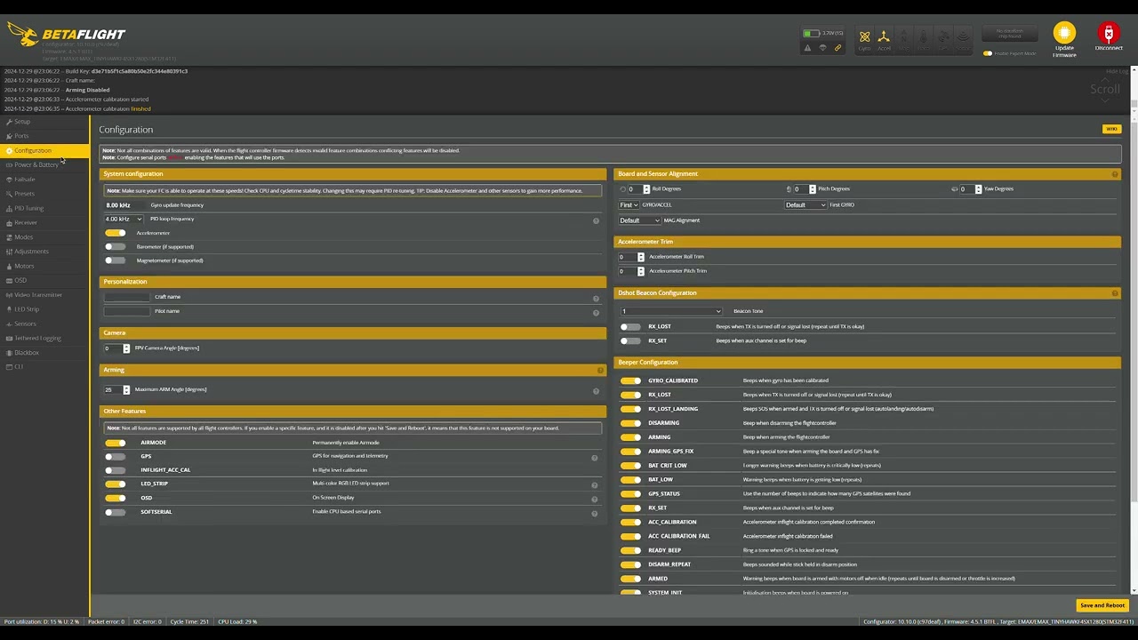

I tried re-flashing firmware, flashing older version, re-calibrating accelerometer many times, changed props, checked the board for any damage.
Sorry to hear about this, I have passed the request onto Emax so should have reply back to you soon.
For the faulty gyro, do you have any screenshots showing this as per our help guide : Flight Controller has a bad/faulty Gyro - How To Test in BetaFlight as Emax may need to see this to confirm the gyro issue?

Hey, as I’m a new user, I cannot upload attachments - I’ve created a video walking through tabs in betaflight showing all of my configs:
