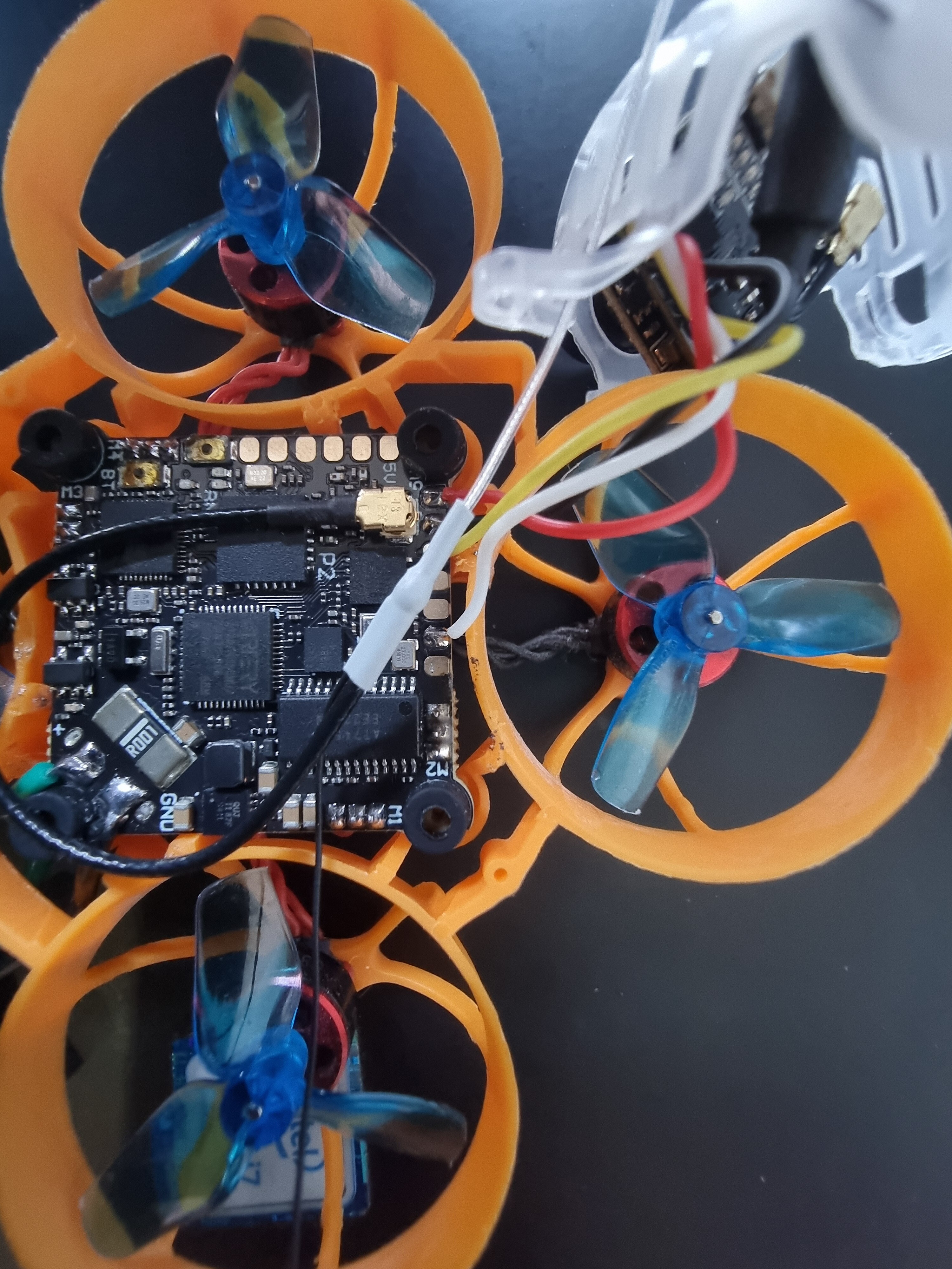

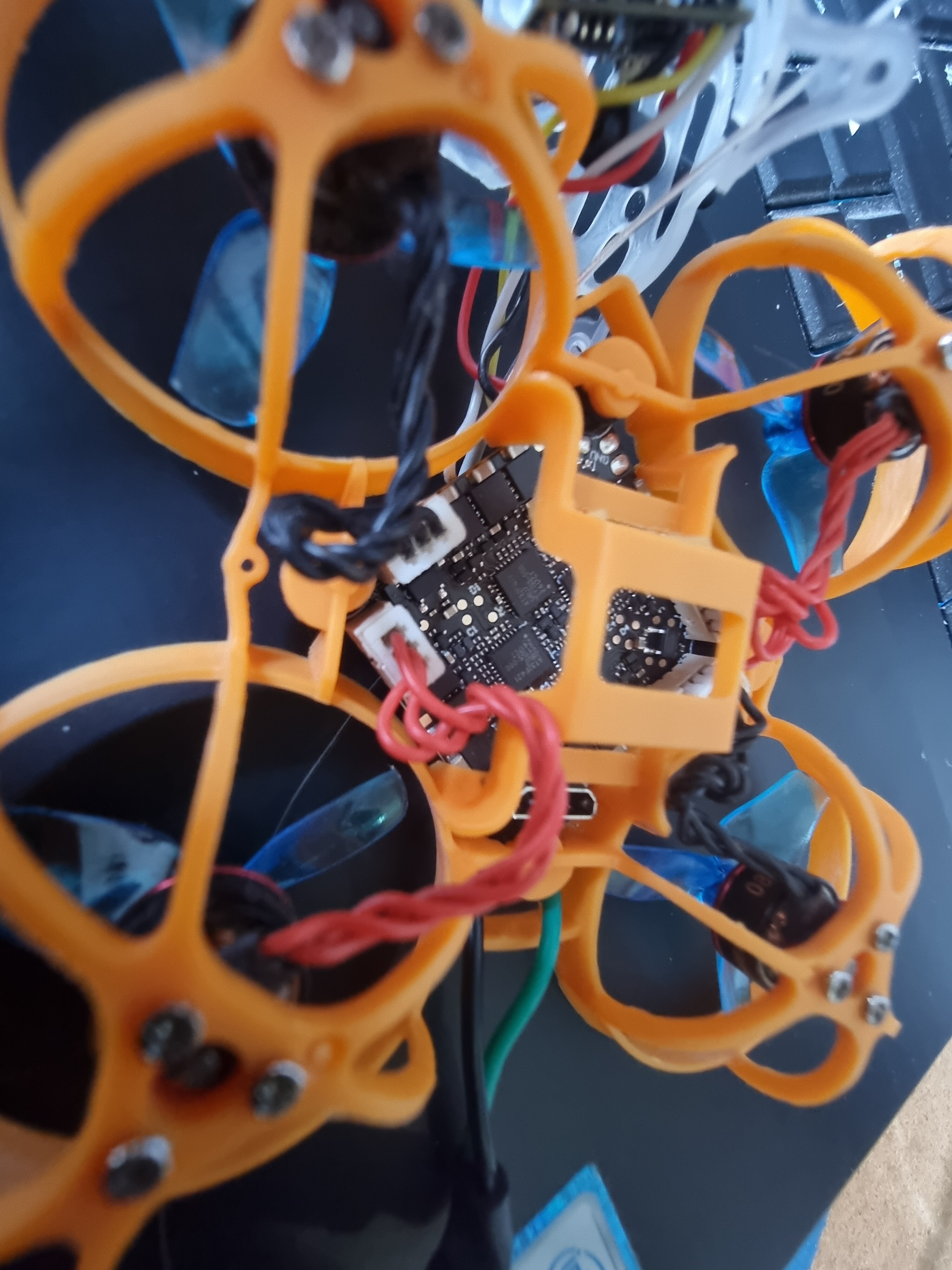

One motor not spin when armed,rest 3 working as should.
I have swapped the motors around and found the issue remains on the same ESC regardless of motor.

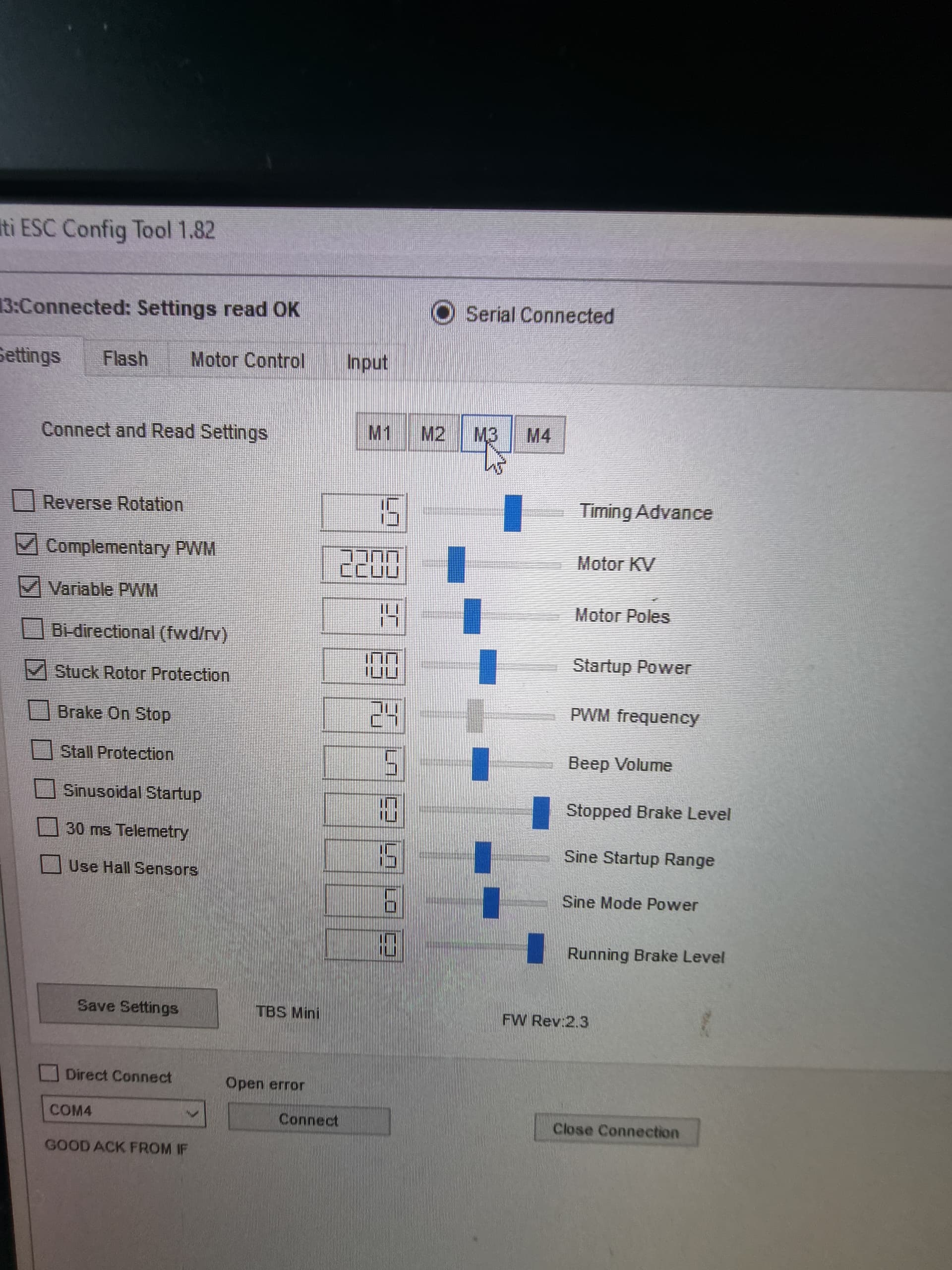

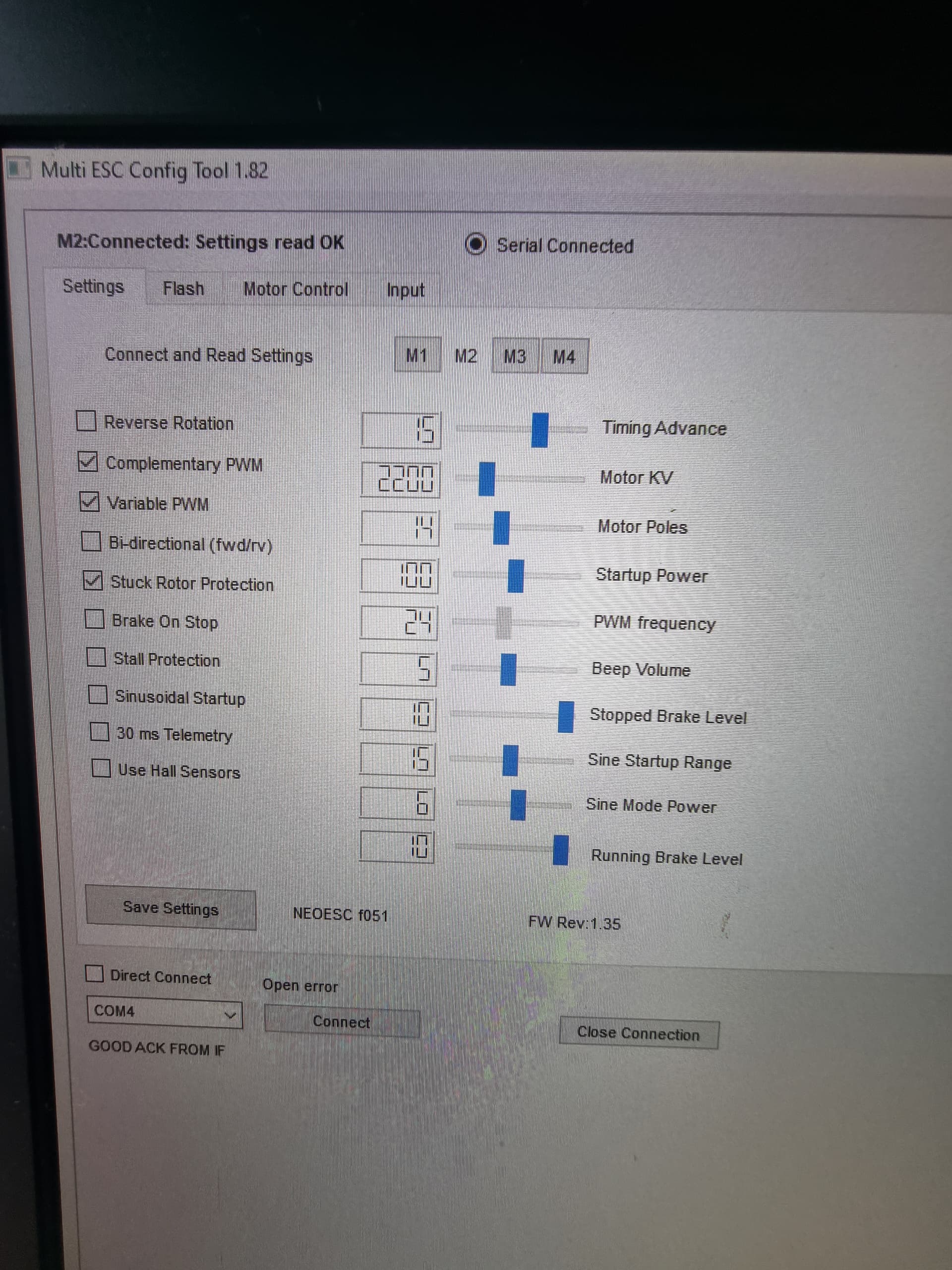

Esc number 2 have wrong firmware installed
Reflashed ESC and works fine. Sorry for disturbing.
