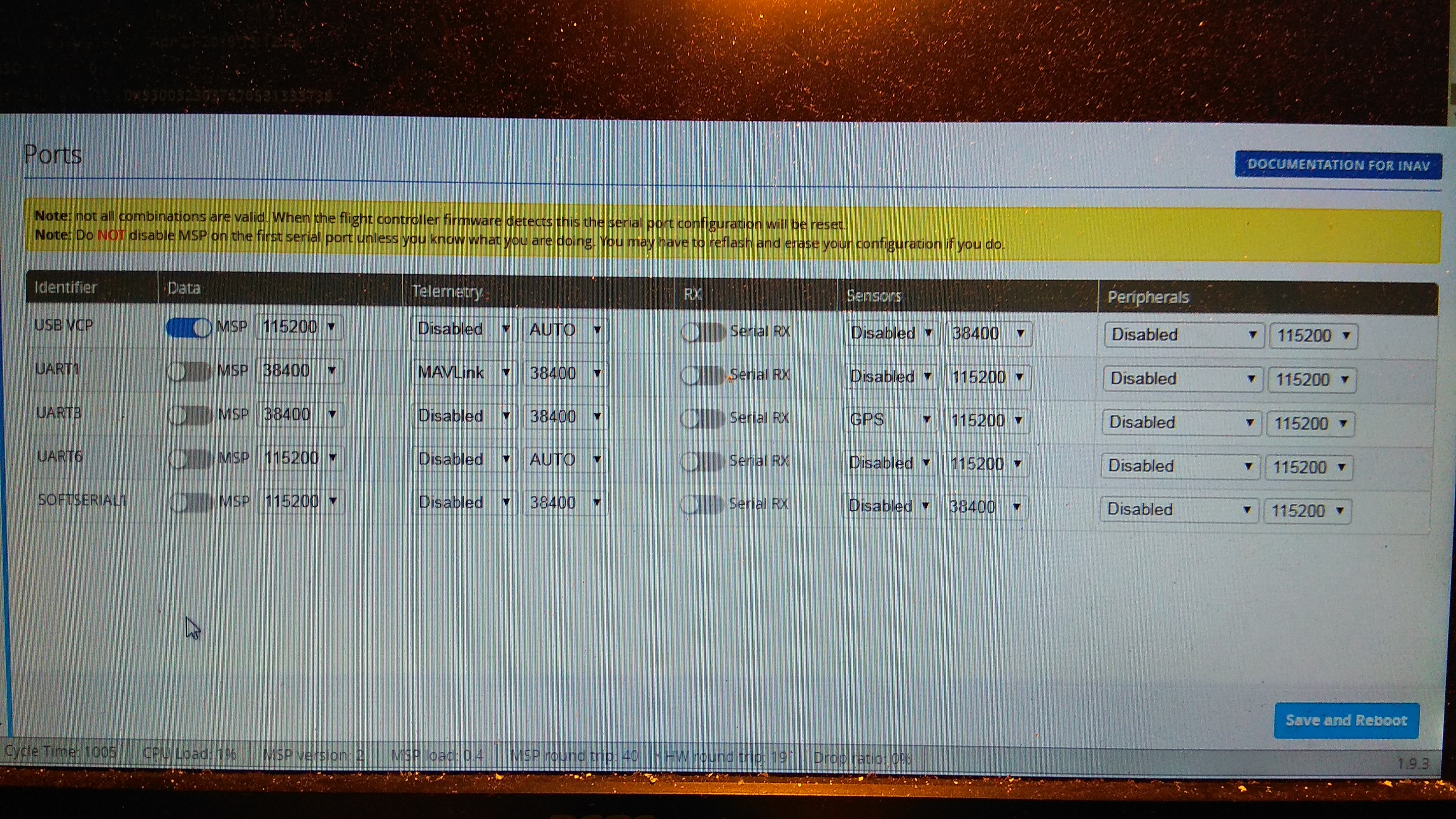

I successfully get data from Mavlink on UART1 but,only few things works on this connection such a gps,compass, altitude etc.Im using Android QGroundControl.I can’t upload my mission on in.Ive try to connect with ezgui and inav from android but not success only for few second and disconnected again and again.This is my configurations.
I dont think you can use Qgroundcontrol to set waypoints in betaflight, as this is not realy supported in the software. Unless I am mistaken? I have never used betaflight for this so I do not know for sure. I always use APM based systems (like Pixhawk) for GPS navigation platforms

im using UART 1 for Mavlink connection and activated Telemetry on UART 1 on inav configurator.Is there any configuration that i need to do?
