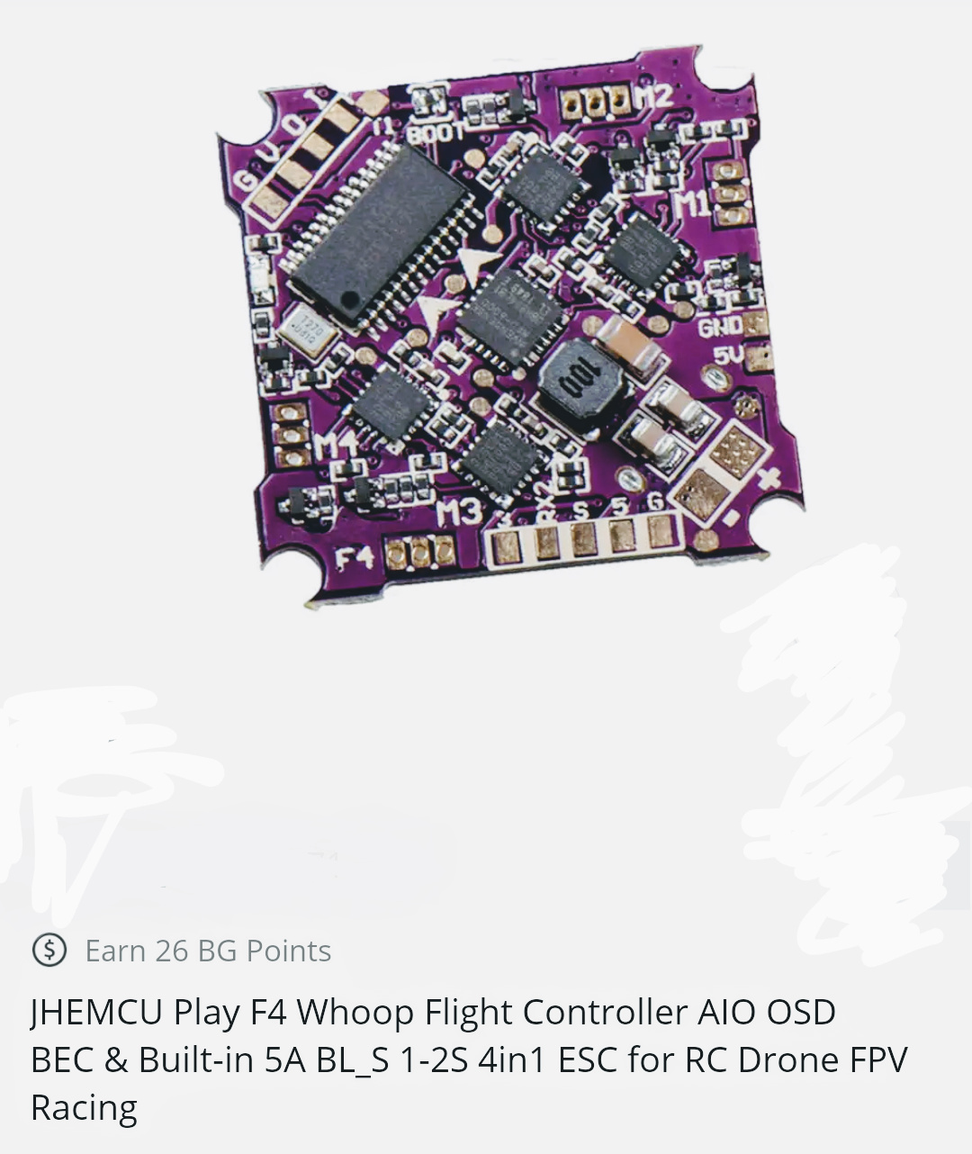

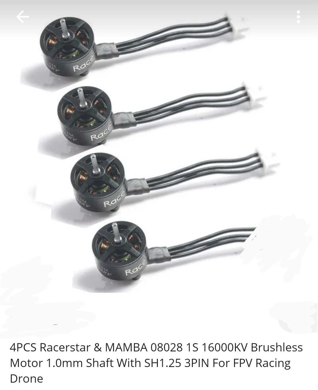

I can’t get these guys to work together. For some reason the number 2/3 ESCs will only vibrate the motors when I test them in betaflight. The motors work ok if I move them to different locations and the ESCs work with different motors.
What am
I missing here?
FC ESC AIO: JHEMCU play F4
MOTORS: RaceStar & Mamba 08028 1S 16000KV
did you install jazz maverick firmware. mine were doing that when I tried. had to revert
