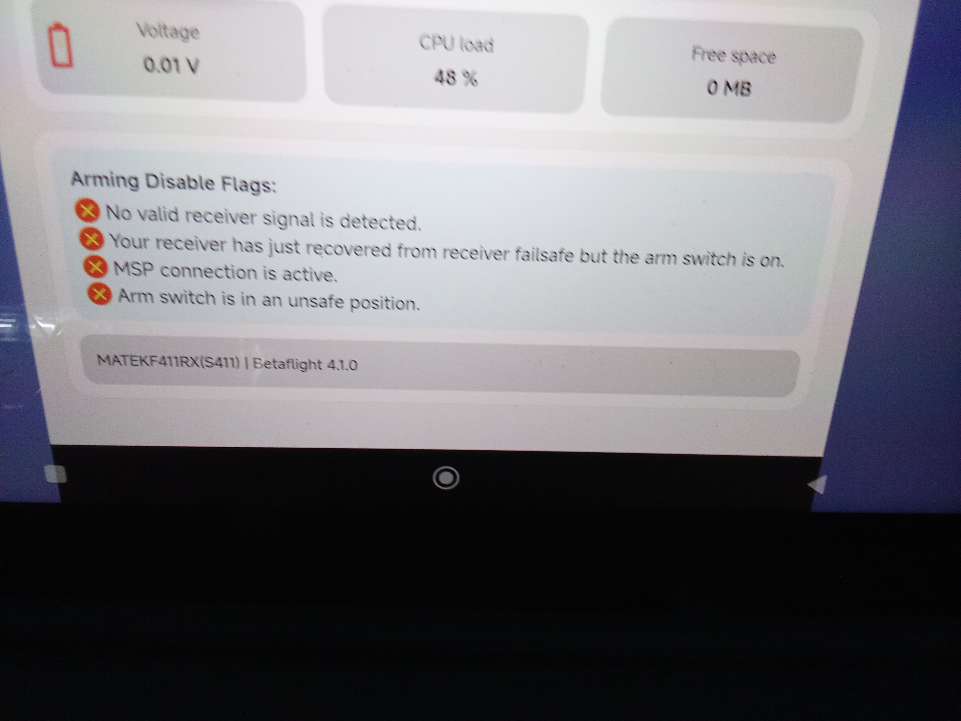

All 5 quads bind,but have multiple RX recovery flag’s in beta flight ,external modules all work and D8 quads work on other TX tried.
In the reciever tab channels do not correspond and throttle joggles aux 2 etc.

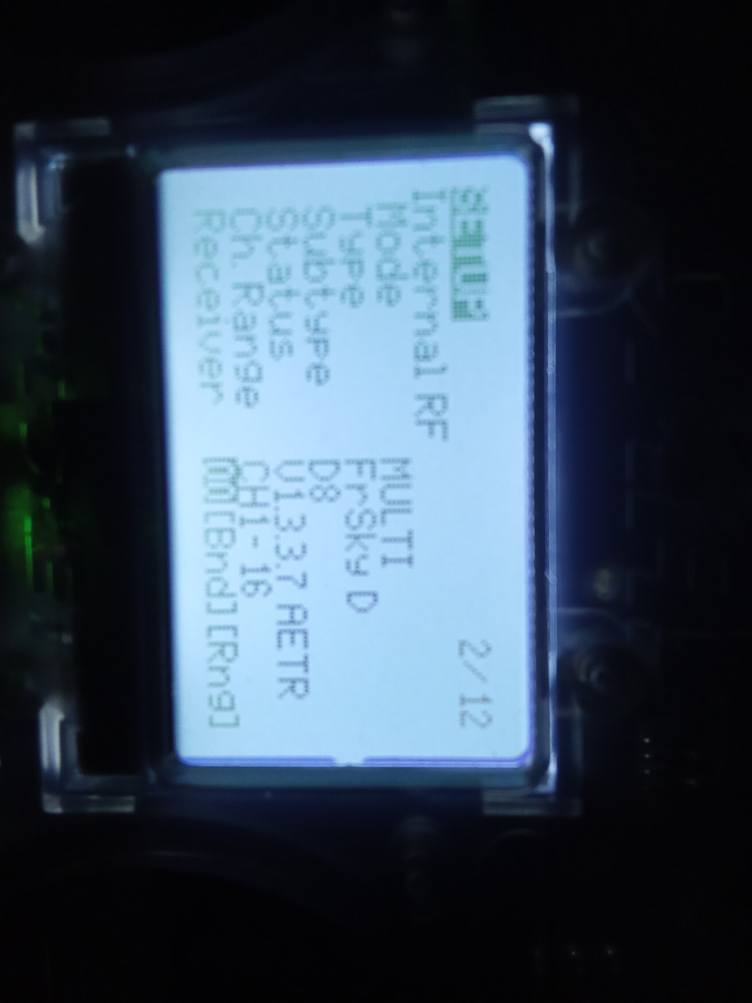

Sometimes, updating the firmware can resolve binding issues. Set the internal RF mode to MULTI, type to FrSky, and subtype to D8

thank you for the reply ,but as I think I said I cannot find any options within edge TX regarding FRsky D8 …where are they located?
I select Multi and FrskyD as type and D8 as subtype but their is no other option to change FCC or LBT that I can find in Edge TX !

Can you please try to change to Frsky X in the menus, then select CH_8, or EU_8 depending if your Frsky receiver on your drone is FCC or EU-LBT mode.
YOu do this in the Radio Setup screen as per your photo above, change from Frsky D, to Frsky X, and the subtype select CH_8, or EU_8 depending if your Frsky receiver on your drone is FCC or EU-LBT mode.
