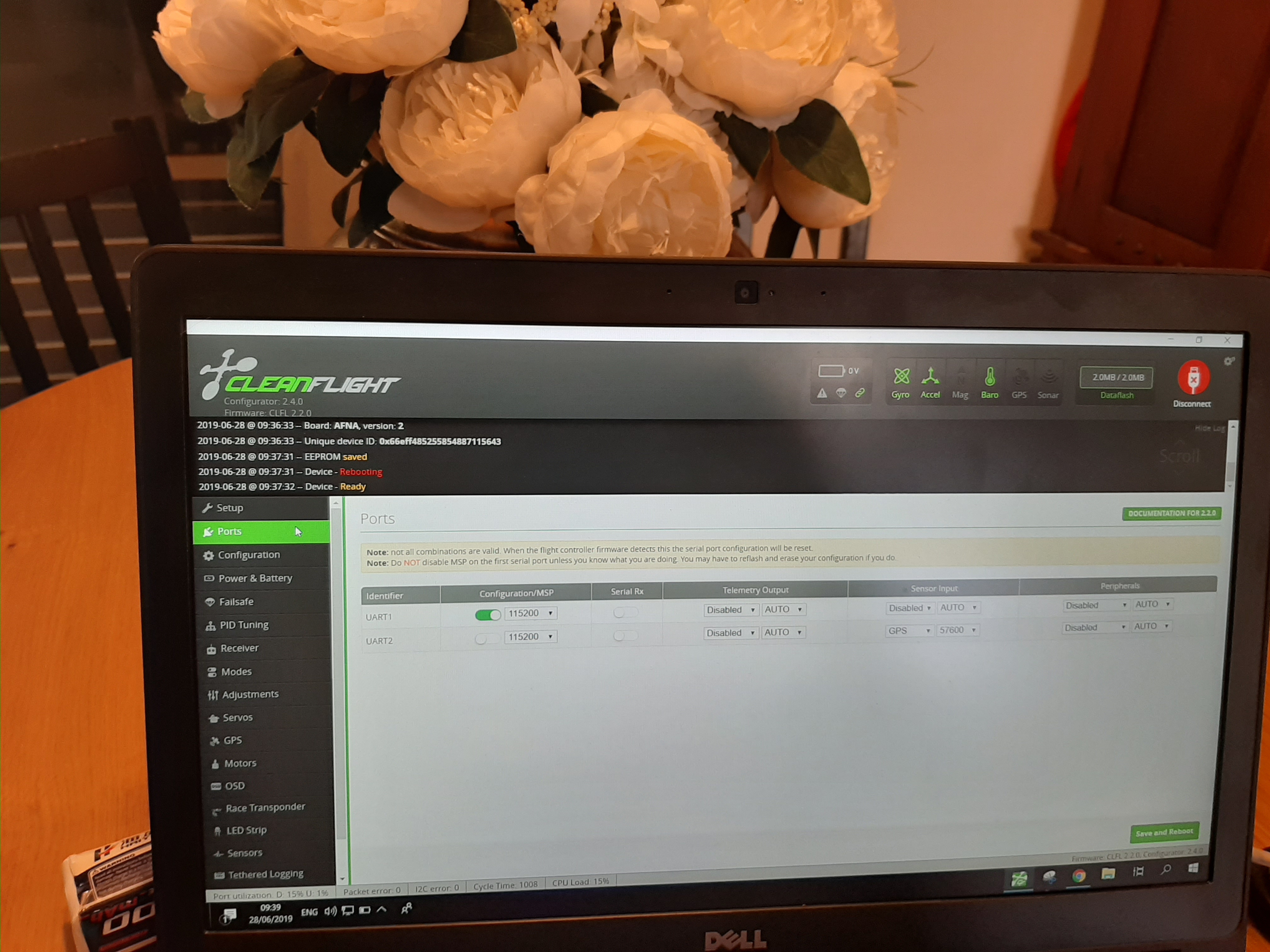

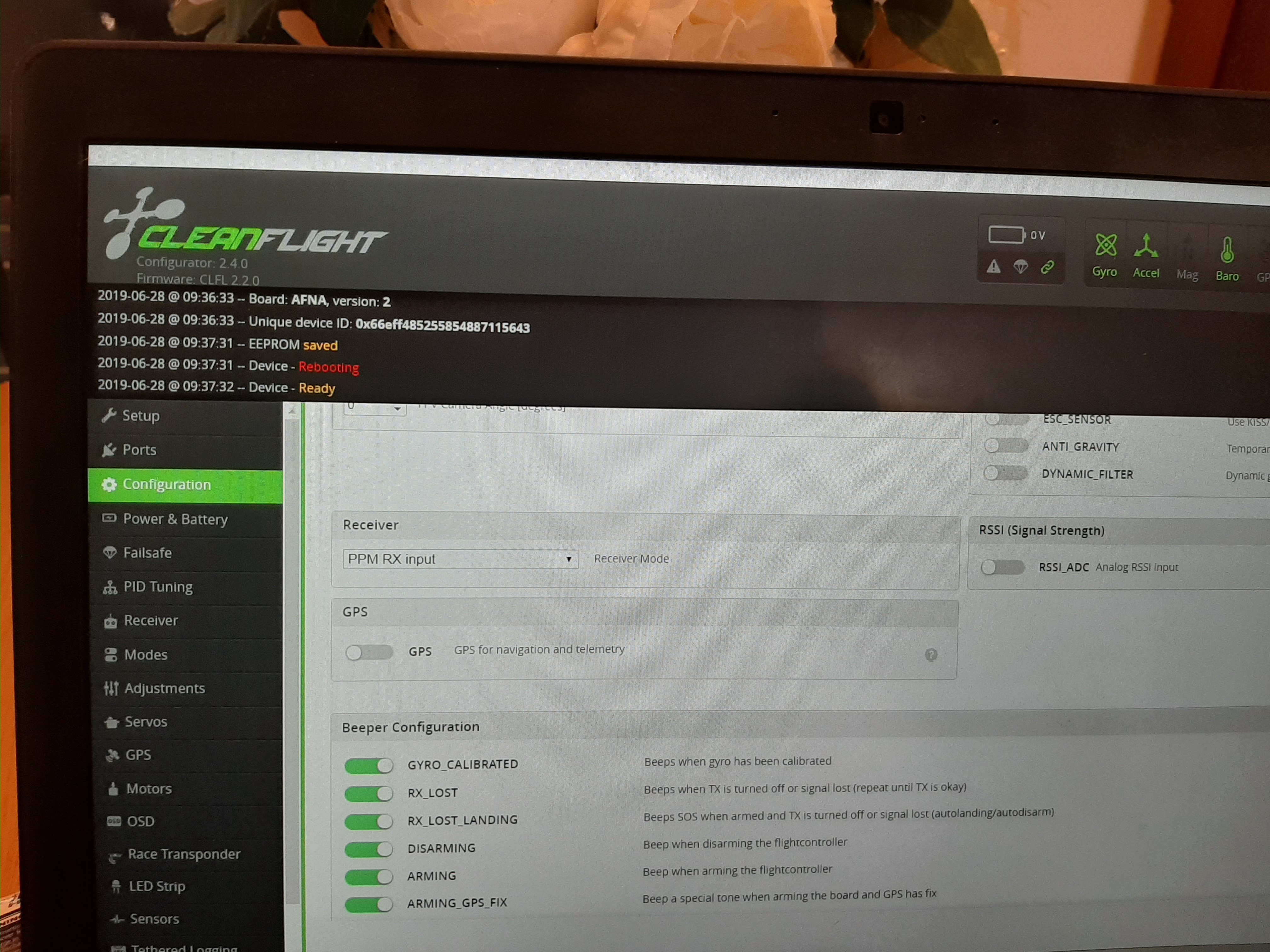

Hi I have naze32 rev6 full version and I’m trying to connect nz gps and icant open the gps tab maybe someone know how to do it ? The version on the board is 2.2.0 mar 3 2018
assuming you have connected it correctly try reducing baud to 38—.
make sure the version of cleanflight still surpports gps on naze 32
infact just checked myself and the 3rd line on notes says gps disabled on your version.

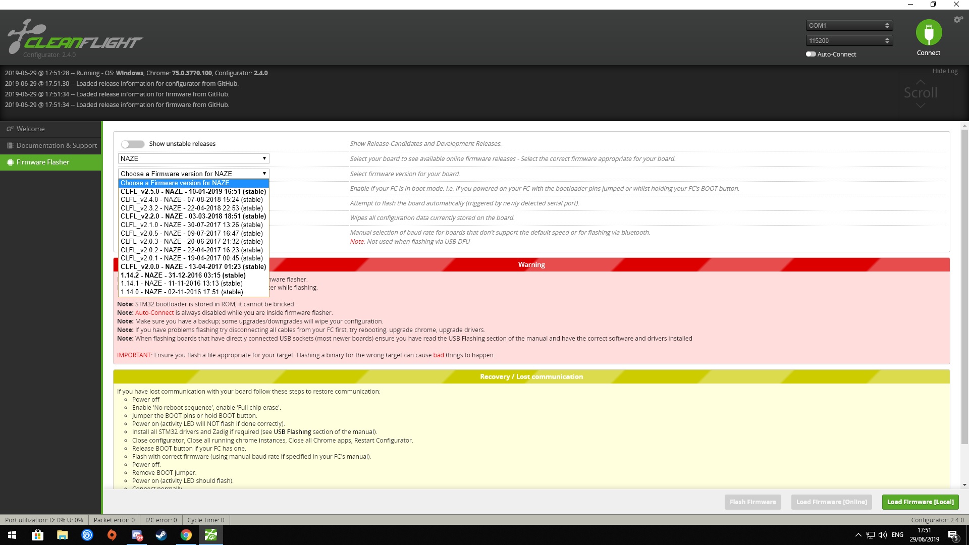

try older 1.14.2 this i know worked for me.
naze 32 is rearly to old now, although i still fly one quad with rev 6 in and it still flies great.
Thanks, where I can find this old version and download it?
when you click to download naze should be in the firmwear part
