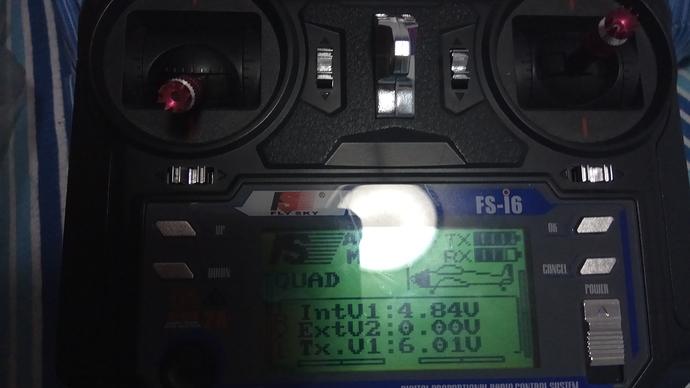

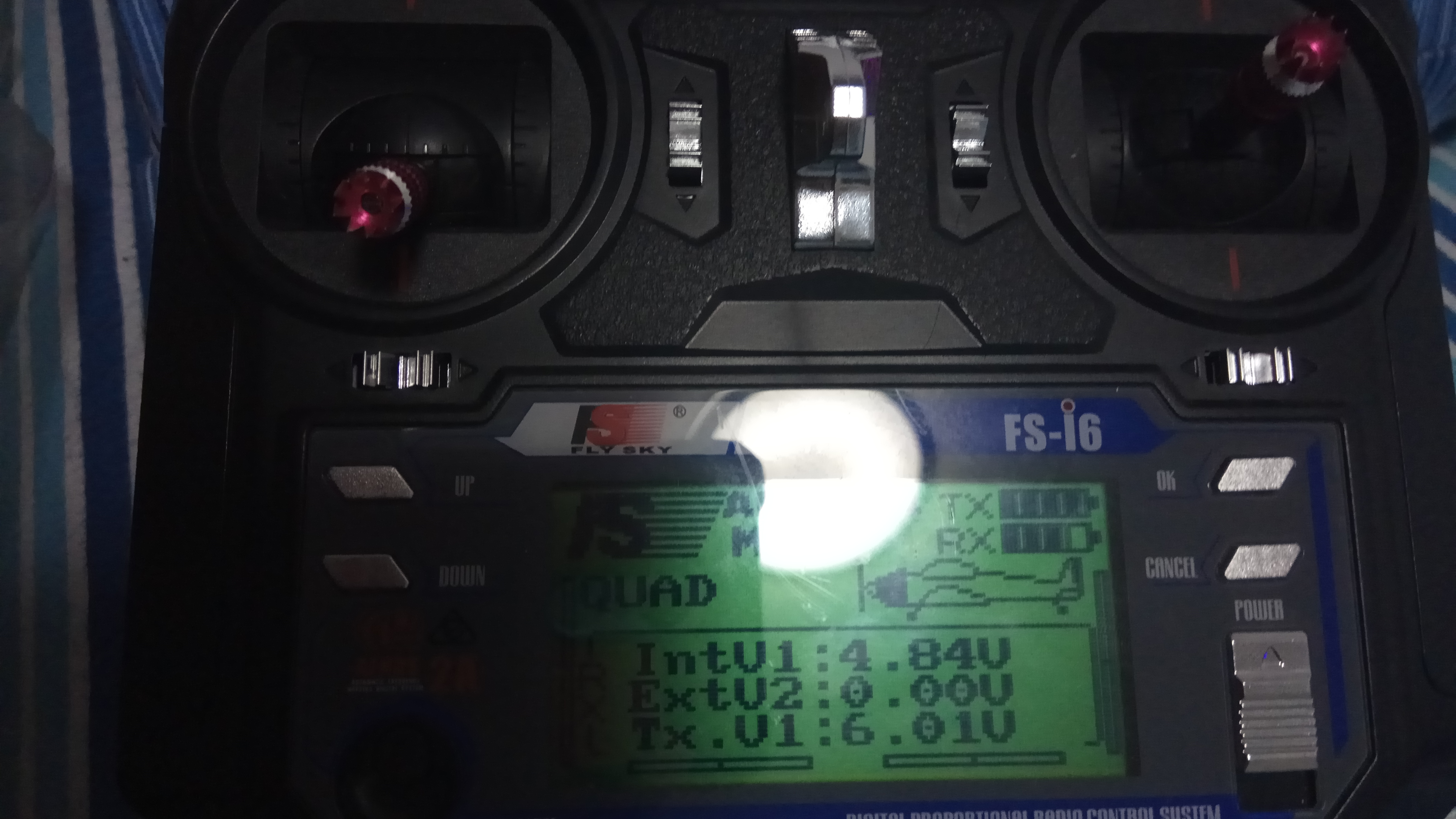

Hey guys,
So I noticed after a few flights I did with my drone that the RX battery status in my FS-i6 transmitter doesn’t change, its stuck in 3/4 of the battery meter, is it supposed to be like that? there is something I can do or I didn’t do? my vbatt are connected and I see the battery voltage in betaflight, my FC is SPF3 and my PDB is MATEK XT-60, thank you.
It won’t change as it’s getting a reading from the voltage supplied by your FC.
The ExtV2 value will however show you the actual battery voltage if you have X6B receiver as it allows battery telemetry to be sent to your i6.
I have Turnigy FS-ia6c reciever
Ok, so the B-Det port will give you voltage telemetry of your flight battery which will show as ExtV2 on your radio.
The Voltage of the FC will not change as this is being supplied a constant voltage (presumably from your PDB or a BEC) regardless of the actual battery voltage, and this is passed on to power your iA6C.
I’m sorry but I didn’t understand you, the ExtV2 in my remote is 0

The reason ExtV2 shows 0 is because B-Det is not hooked up
