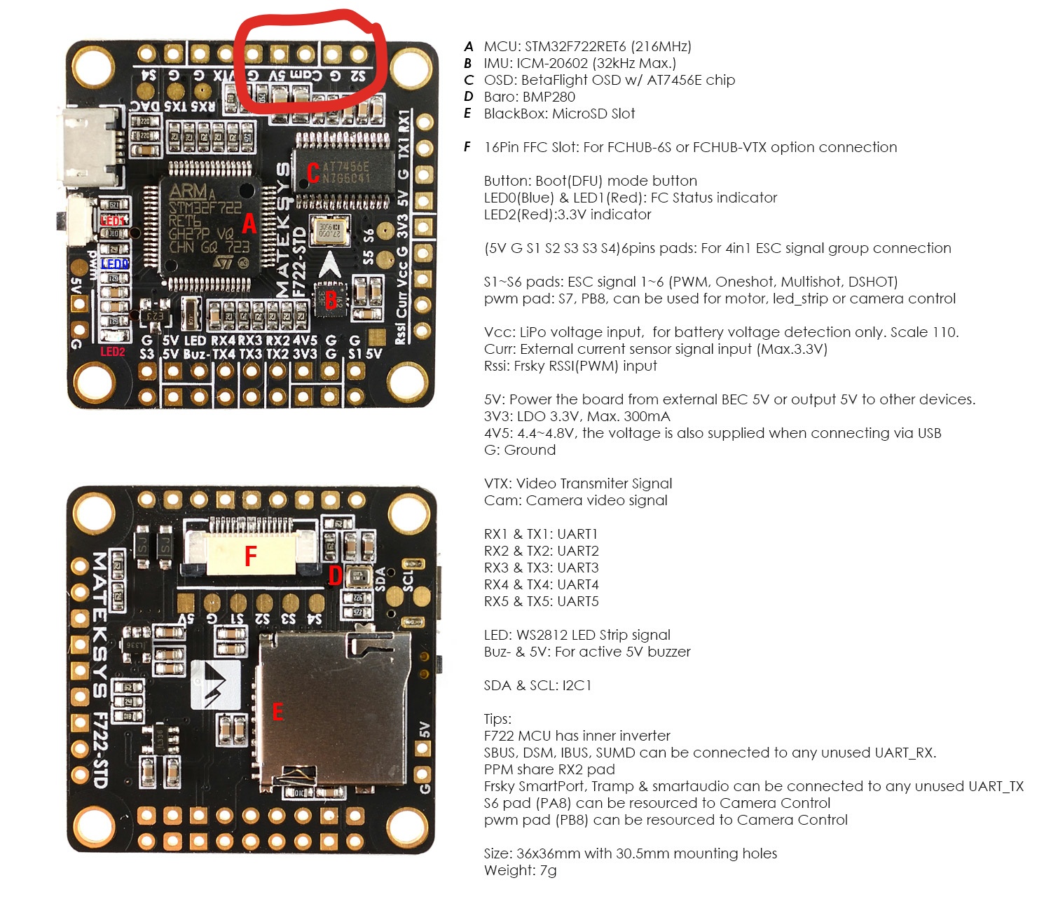

does anyone know what is osd tab in betaflight? where does that osd show? radio?
When I connect my FS-A8S it doesnt show battery level or things like that on my radio(jumper t12). Anyone know how to do those?
I’m using a matek f722 and how do I flight info on my fpv cam? I wonder if these have anything to do with it.
