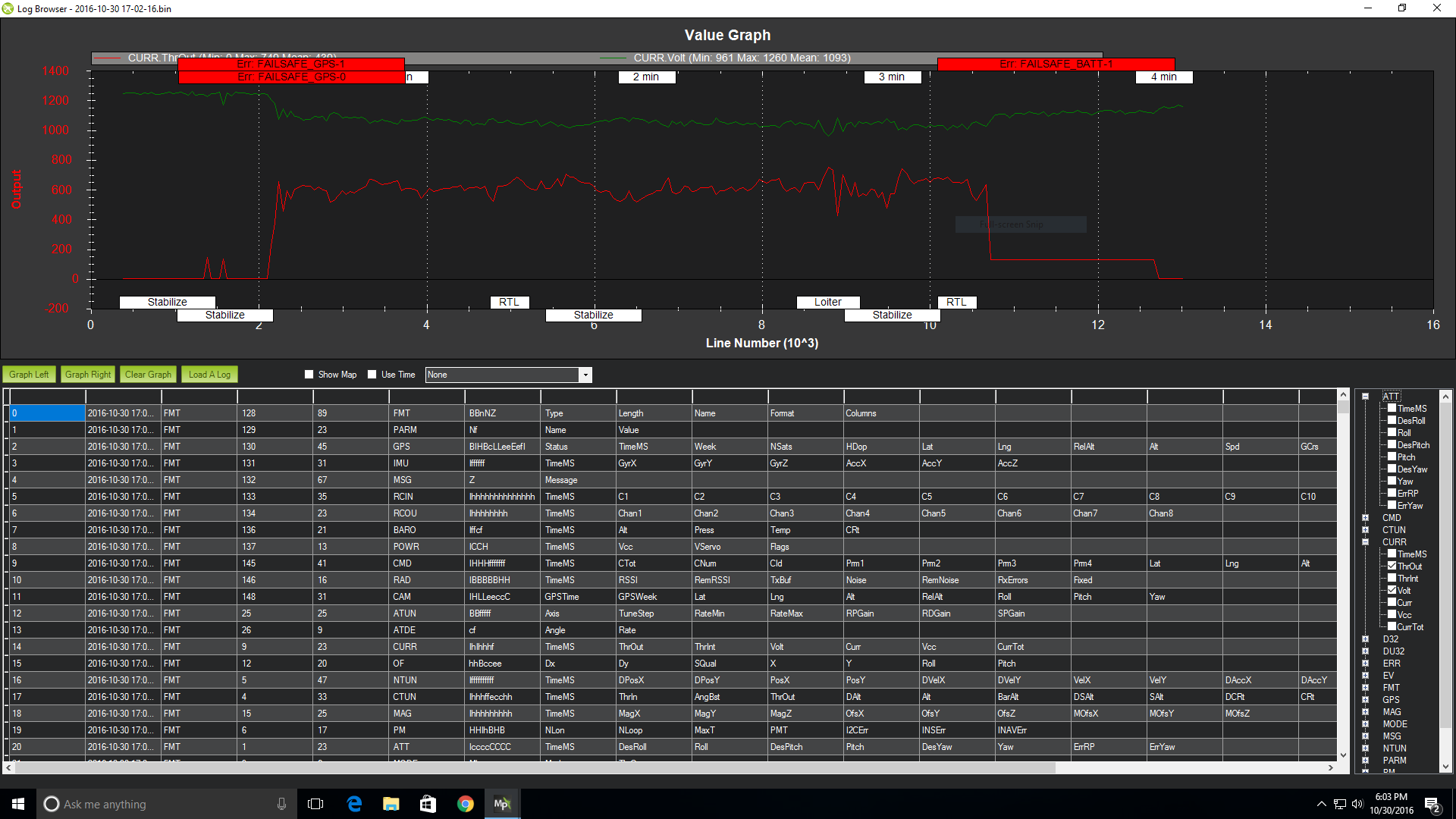

@Paul_La_Fors It drops as ThrOut goes up. The relationship is almost direct, I can upload a log (.bin) file if you want to see one.
OK upload your log. Hope can help you in some way
There’s the screenshot, which should be enough. I will find a file hosting place for the .bin file if you really want that. The red line is ThrOut, and the green line is Volt. You can see the voltage dropping as I apply more power.
