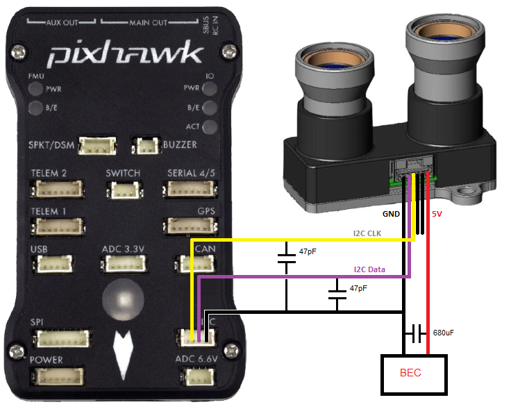

Hi guys,
I was wondering if it is possible to use a Lidar Lite with the Mini Unmanned Hawk as it works fine with my Pixhawk?
Thanks.
Hello,
A nice guide on how to do this can be found on the LIDAR-Lite Rangefinder page on the ardupilot website. The only difference between this and the Mini Unmanned Hawk is the location of the I2C port.
