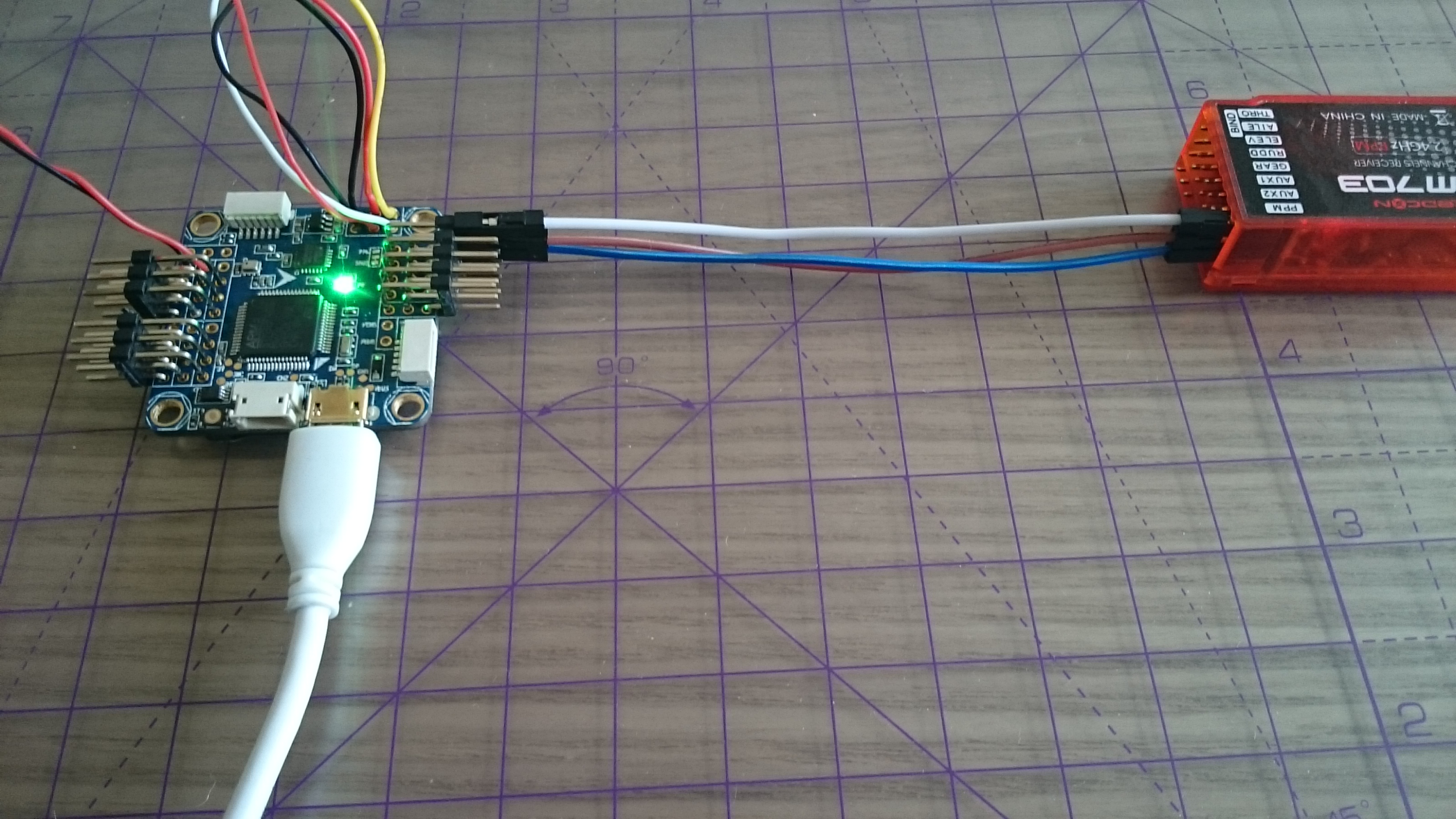

The DSMX receiver is a Redcon CM703,
I’ve tried setting UART1/3/6 to serial RX, PPM/SPEKTRUM2048/anything but nothing works. Does someone have the same setup? Any help is much appreciated.
This is how it is wired:
Looks like its connected ok, but could not tell from the photo, but it looks like you still need to solder the SBUS/PPM jumper:
For PPM you need to solder a jumper between the PPM pad and the middle pad, then it should work once you set the receiver type to be PPM within betaflight.
Hope that solves the issue
I’ll find out. Thank you for your reply
It worked! I cut the existing SBUS bridge with a box cutter and dropped some solder on the other 2 pads to set the jumper to PPM.
