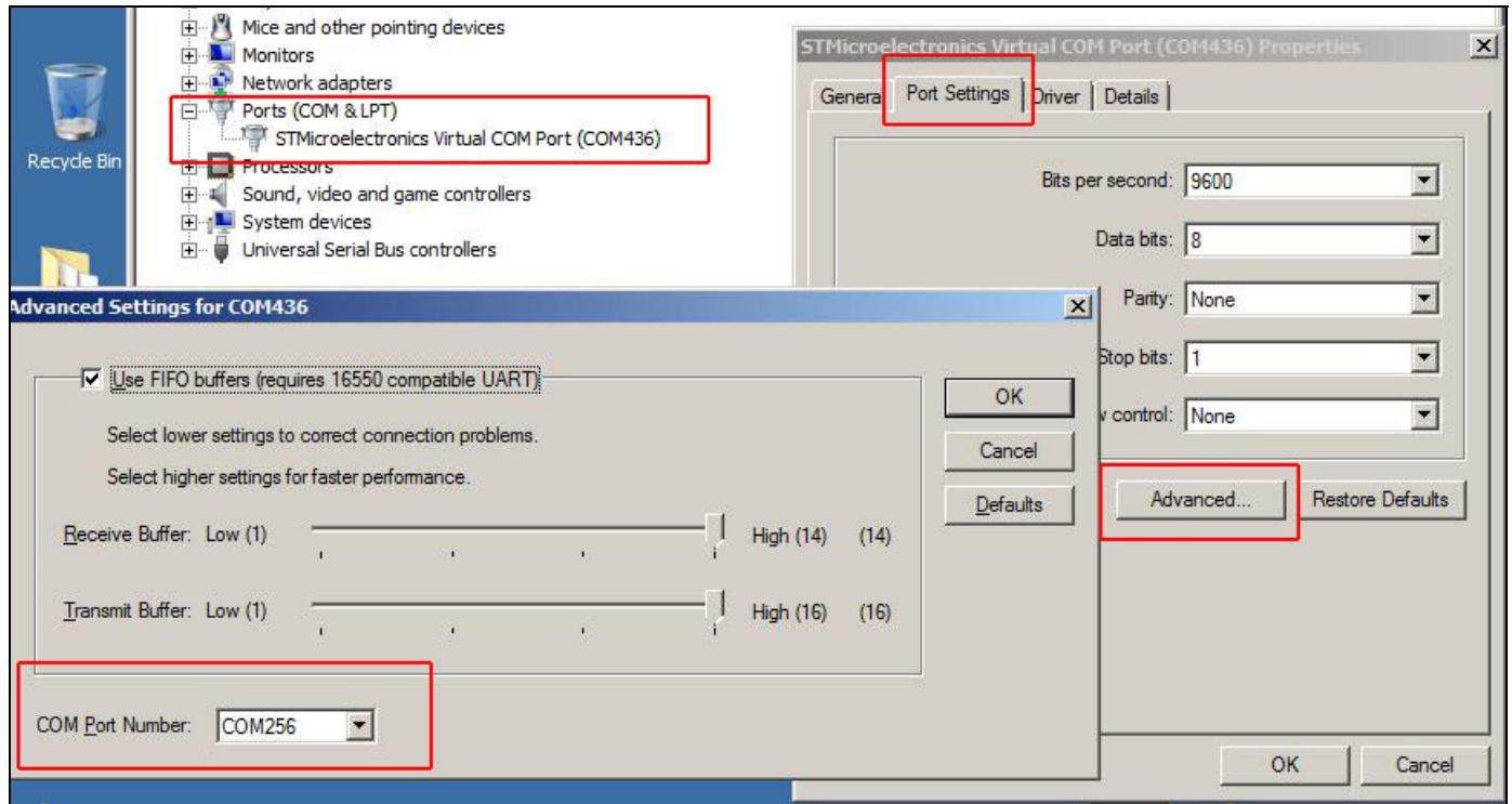

If this is the case all you need to do is open up device manager and manually change the number to something less than 255. To change this you go to the device properties, Port Settings tab, and click on Advanced. Within that screen you can set the COM port number manually as shown above.
