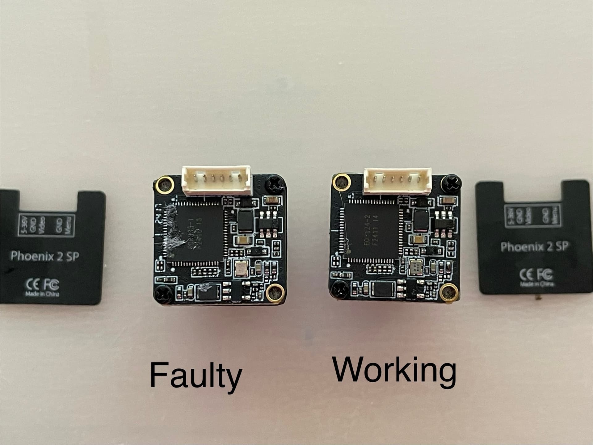

The supplier has asked photos/videos for the following:
Photo/Video showing the two cameras
Motherboard for two cameras (remove the back panel)
Note: It is best to mark the good/bad cameras, and also label the pictures with names.
Once you provide the requested information or items, we will proceed with the next steps.

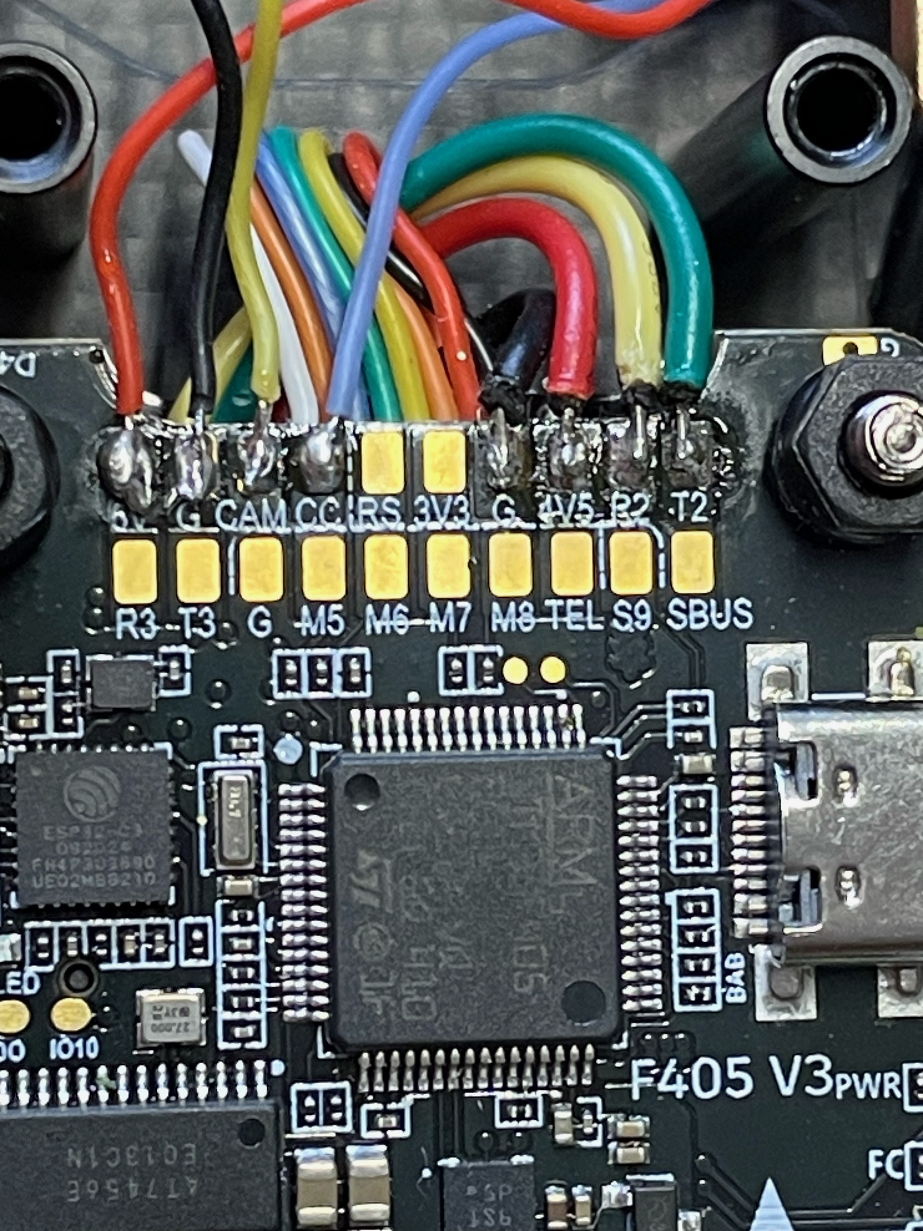

Images as requested. There were no wiring changes between installing the original faulty camera and the working camera. Voltages and connections were correct.
