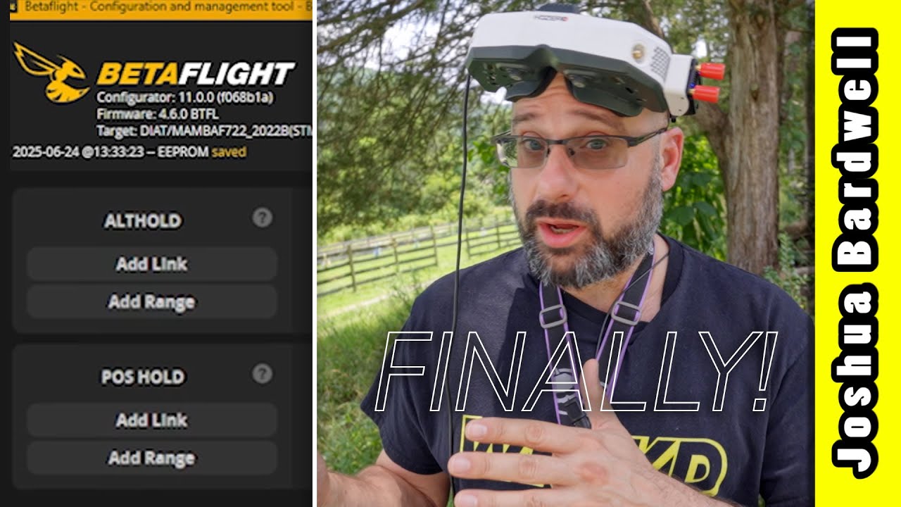

Betaflight 4.6 is stirring the pot with its new party tricks: position hold (POSHOLD) and altitude hold (ALTHOLD). Perfect for when your drone decides to wander off like it’s had one too many gin and tonics. While flashing this pre-release is a bit of a faff, you’ll need the new Configurator 11.0 or opt for the web version. Just remember, it’s all in the tweaking—especially if you’re not blessed with a compass. Fortunately, POSHOLD can manage surprisingly well without one… just don’t forget to fly straight for the calibration.
Diving into the nitty-gritty, flashing 4.6 means entering beta territory, which could leave your drone sulking in the corner if things go awry. Get your flight controller into DFU mode, enable expert mode, and make sure to tick those oh-so-important altitude and position hold options before you flash. If you’ve been living under a rock, Bardwell’s guide is a must-read for setting up your GPS and ensuring you’re ready to take flight without a hitch.
Once you’re airborne, calibrating your heading by flying straight is key, unless you fancy your drone taking a little detour while you’re busy sorting out your tea. And if altitude hold has you descending faster than a lead balloon, it’s likely your hover throttle setting needs adjusting—one minor mishap that many pilots encounter.
