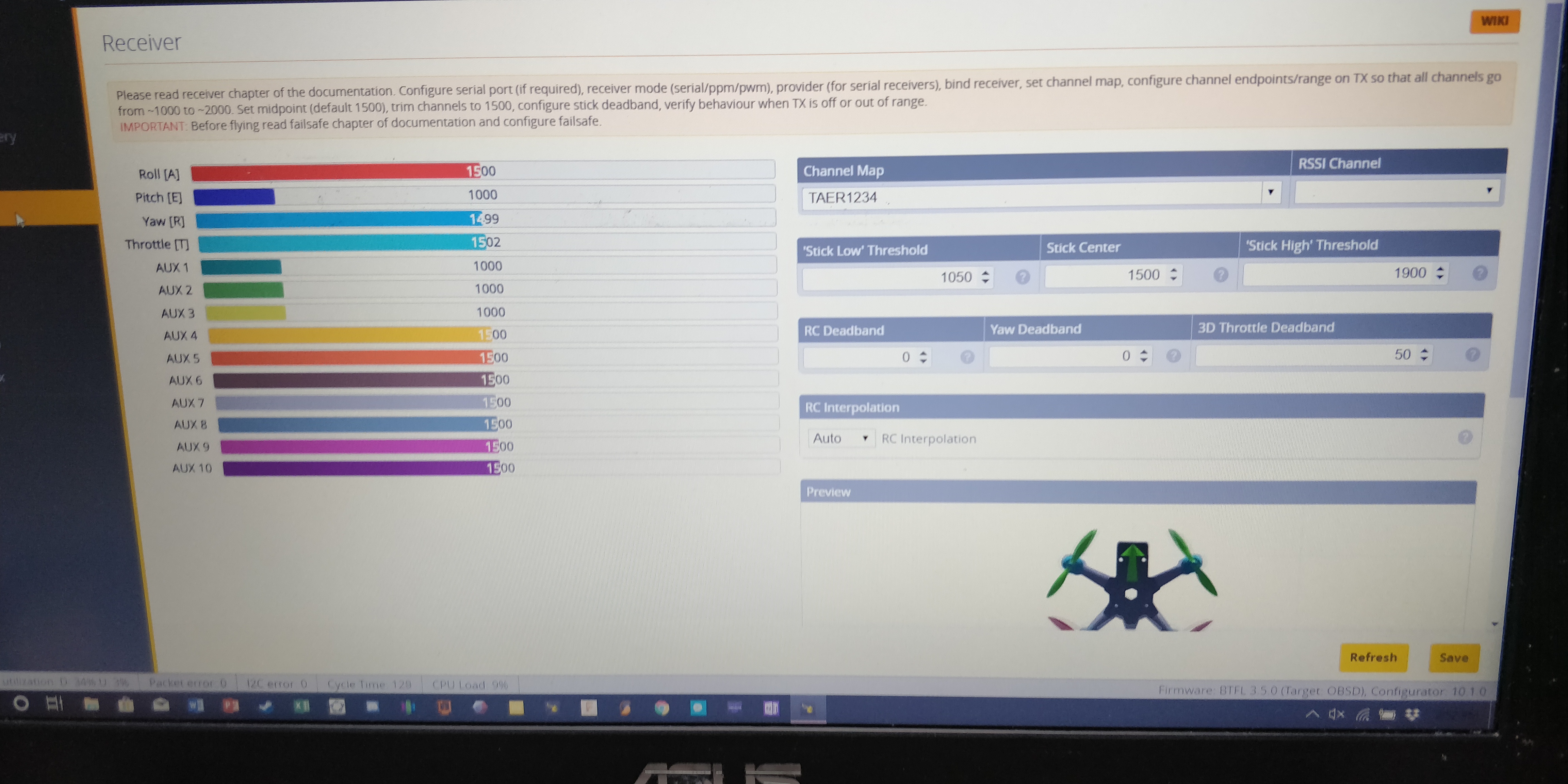

Hi, i have just recieved a beta fpv 75x.
When i go into the reciever tab in betaflight, All the controls arrangementer messed up, my throttle had become pitch and my pitch is throttle. I am normally flying mode 2
I am using a turnigy evolution and a FS-A8S reciever soldered to the rx3 pad
Change the Channel Map
to AETR and save and reboot and try again
Thankyou, that worked!
