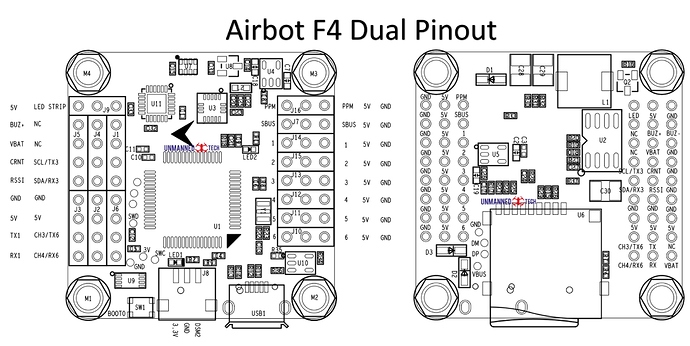

For reference here is the pinout:

Sorry but IMHO I think this image shows LED Strip connection incorrectly

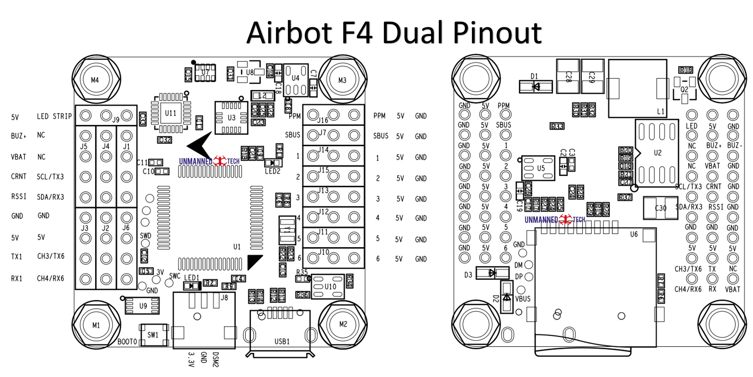

It should be above the buzzer connections (top left corner) not at PWM 5
see image below
Cheers Steve :slight_smile:
