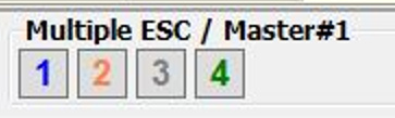

Multi ESC Selector
Near the bottom of the BLHeli Suite window you will see the multi ESC selector in passthrough mode. This allows you to select which ESC you want to read/apply the changes to. You can change the parameters of just 1 ESC, or all of them at once depending on what you want to change. For things like mode, breaking, min/max throttle settings its useful to write that to all ESC’s at once, but other parameters like motor direction you would need to change to pairs or motors or individually.
By clicking or right clicking on the numbers you can select and deselect the various ESC’s to change the setting for specific ESC’s.

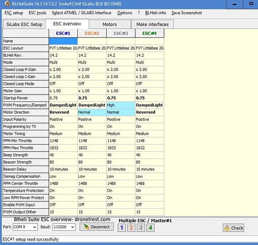

ESC Overview Tab
A great feature of passthough mode is that is has the ESC overview tab. This allows you to see the settings for all of your ESC’s on one screen to see what values are different and which are the same.
In the screenshot above the differences are highlighted in blue. As you can see the 3rd ESC has no active breaking enabled (PWM Frequency/Damped). However the motor direction is correct as two of the motors need to be reversed on order for the quadcopter to fly stably
