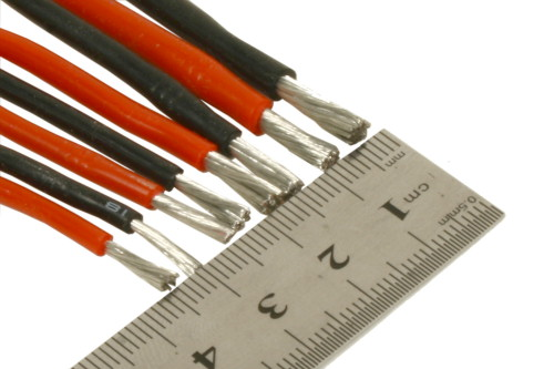

Types of wires
In general you always want to use silicone multi-strand wires as they are nice and flexible. Multi-strad wire just means that instead of a solid strand of copper in the wire, lots of little wires are used stranded together which makes it much more flexible and easy to work with in the small spaces of R/C drones. However they are more expensive than single strand wire.
