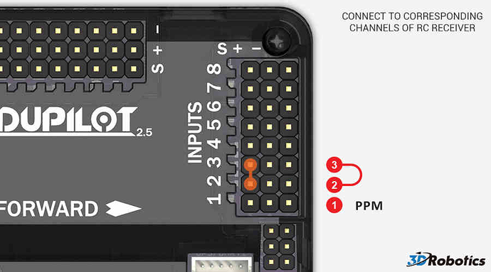

You dont need a PPM encoder for APM as it accepts PWM inputs. Bit if your receiver outputs PPM i would suggest using it as its much easier to connect as APM also accepts PPM if you short inputs 2 and 3.
Its the more recent flight controllers like Pixhawk that need a PPM encoder (if your receiver is only PWM) as Pixhawk does not accept PWM inputs directly, only SBUS or PPM.

blank looks here! I have a devo RX701 receiver, which seemed to make sense - matches the tx, is this PPM or PWM? there is absolutely no information on the packaging
and if it is PPM where would I get my hands on a 2 pin jumper?
cheers!
I believe the RX701 is only a PWM receiver (but I could be wrong as I dont own one)
By default it should be in PWM mode, so each channel requires a cable to the APM board.
