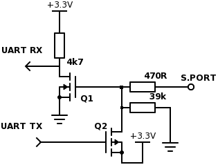

Getting FRsky telemetry on the Revo is abit of a challenge as the board itself does not have a serial inverter which is required for FRsky smartport. You can make your own one
