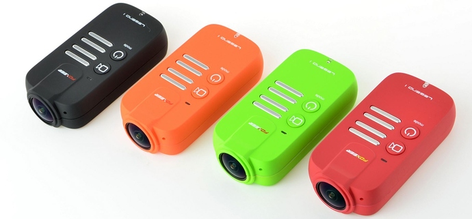

Foxeer are a new player in the FPV game with the legend 1 being their first HD camera. The Legend 1 was released a few months before the Runcam 2, and was one of the first small HD cameras capable of recording at 60fps. The initial reception was rather mediocre, but its great to see that foxeer listen to user feedback and have since released a few firmware updates. The most recent update has drastically improved the image quality and performance assuming you are using a class 10 SD card.

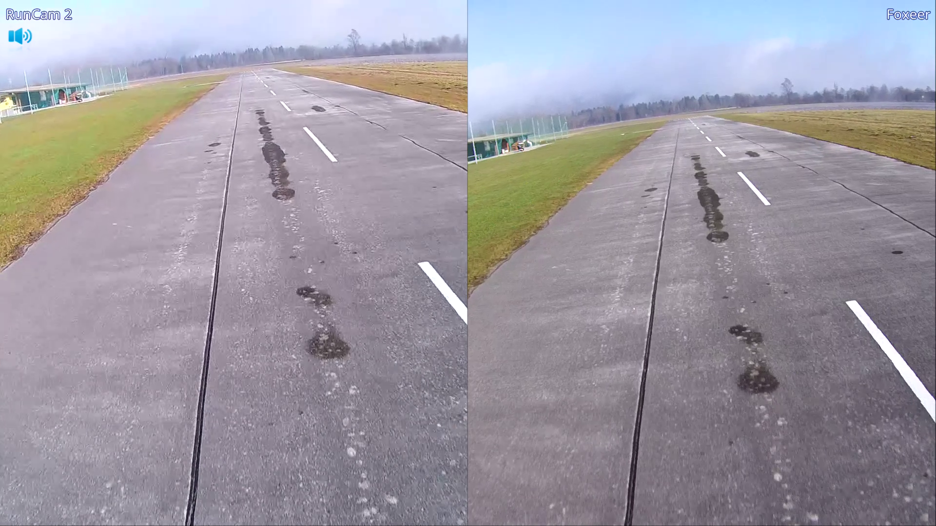

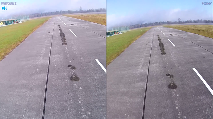

Image Quality
From tests and other reviews there does not seem to be a noticable difference in terms of image quality. Some say that the runcam 2 produces a sharper image, but in my opinion the runcam 2 images are too over sharpened.
for more images check out the great comparison from rcfpvflight.com
The field of view of the runcam 2 is 120 degrees compared to the much wider FOV of the foxeer at 166 degrees. Which is better comes largely down to user preference. Typically for an action camera I think having a wider FOV is more desirable, but it does distort things abit more which could take some getting used to for FPV flying if you are used to smaller FOV cameras.
Many of the first foxeer legend 1 users complained about the poor video quality, and also some issues with missing frames during recording. However since then foxeer have released a series of firmware upgrades to address these issues. Its also worth noting that the foxeer legend can actually record 1296P Super HD videos at 30fps if you enable this mode via the PC app.

Foxeer are much more open about their camera specifications as they say it runs an ambarella image processor (same company that makes Gopro image processing chips), and the actual sensor is a 16MP Sony Examor R BSI sensor. I could not find any details of the image processor or sensor on the runcam. However both record the same resolution video with the maximum being 1080P at 60 frames per second.

The most notable thing that sets the foxeer apart from the runcam is the fact that it lets you control when to start or stop recording videos or taking photos via your R/C control which is ideal for certain situations. On the other-hand the runcam2 includes integrated wifi with an android/IOS APP which lets you setup, and set the parameters of your camera with ease.
