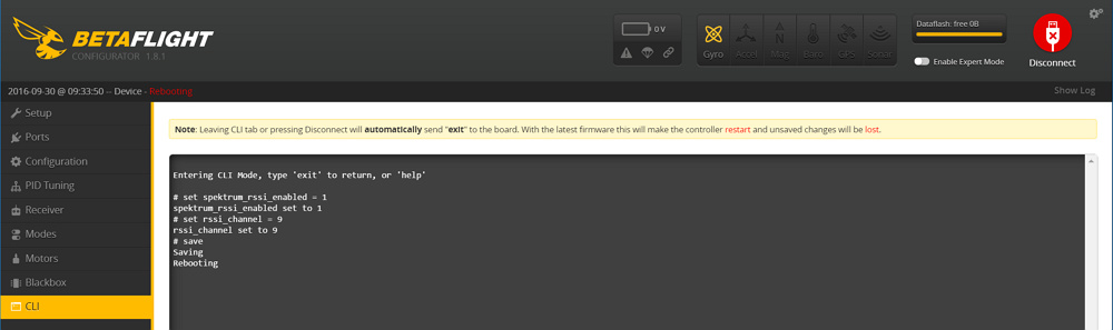

Use commands:
set spektrum_rssi_enabled = 1
set rssi_channel = 9
save

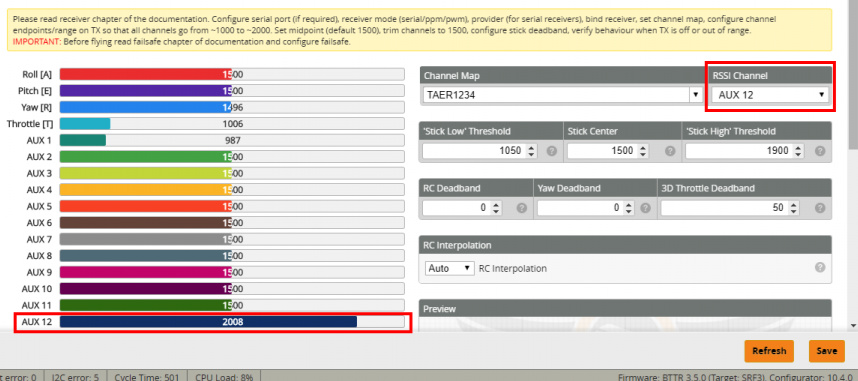

Then go to the receiver tab in betaflight to tell which channel is reporting RSSI (the same channel you set the RSSI in the step above). Remember to press the save button when done.

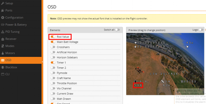

Then the last step is to enable RSSI on the OSD

Aux 12 in betaflight is Channel 16 on your transmitter.
I found that the command “set spektrum_rssi_enabled = 1” shows as an invalid command, however when i typed “set rssi_channel = 9”, changing the 9 to 8 as i use a Dx8, it works as it should. Thanks for your help, i now have some reassurance in how far away i can fly and still be safe. Thanks again, you guys are a mine of information.
