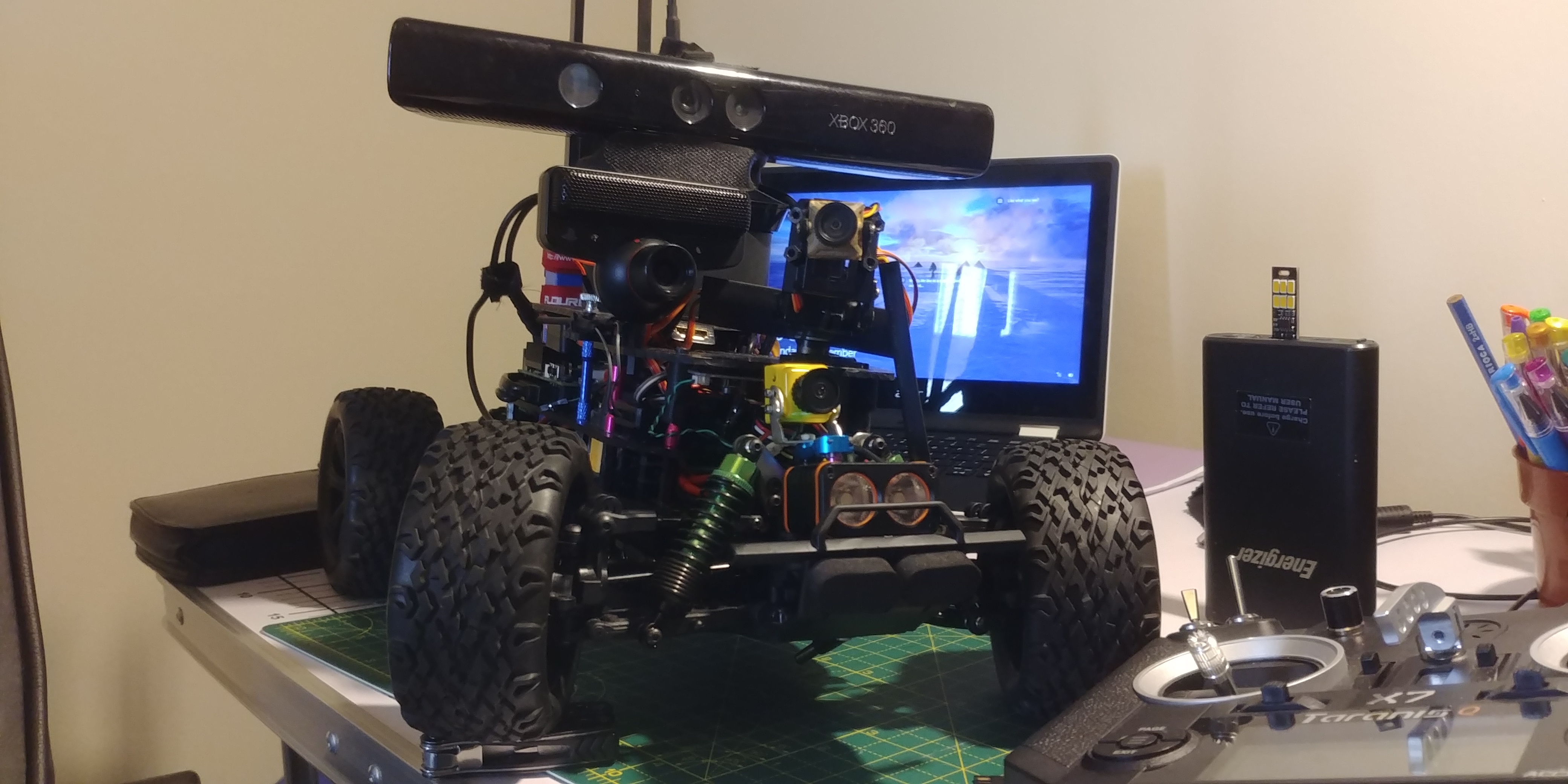

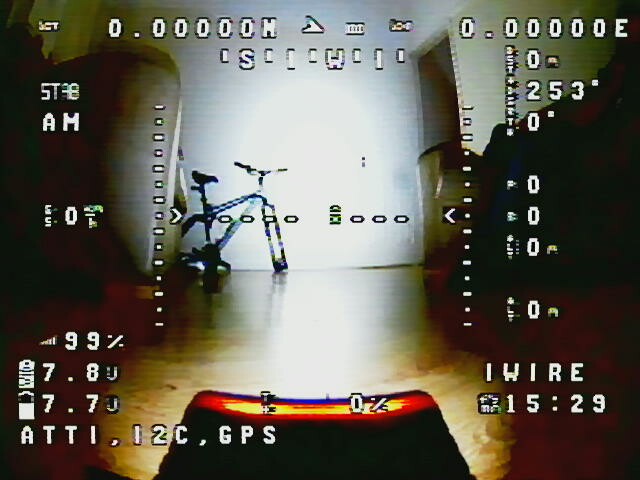

I have a robotic rover, ugv,whatever… with hud, pan/tilt geo-stabilized,arduino due,computer, Ros,it scan in 3d etc, etc.

I have all of them, I dont use ardurover. Yeah, it have autonomous driving but to much limited. If you want something serious, the way is companion computer with ROS or better ROS2 when it be ready.7180

Akrae, thanks for the info and pics, the rover looks great. I tried ROS but I found it very hard work. I got it running Ok but could not actually get a robot in Gazebo at all working. My bad, just keep having trouble with the complexity of “you have to use ubunto 14.0.3 and unbuntu 14.0.4 doesn’t work” (made up names) and ROS 14 only works with this version and not with that. There is a company putting ROS on hardware and that might be easier.
