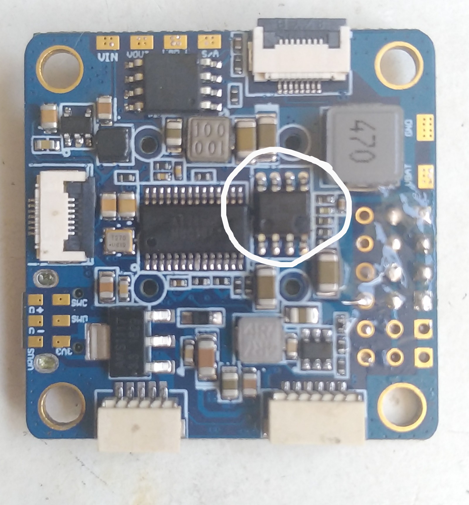

Hi everyone, I have burned out a component, guess it is 5V regulator. Can anyone tell me exact details so I can replace with a new one??
