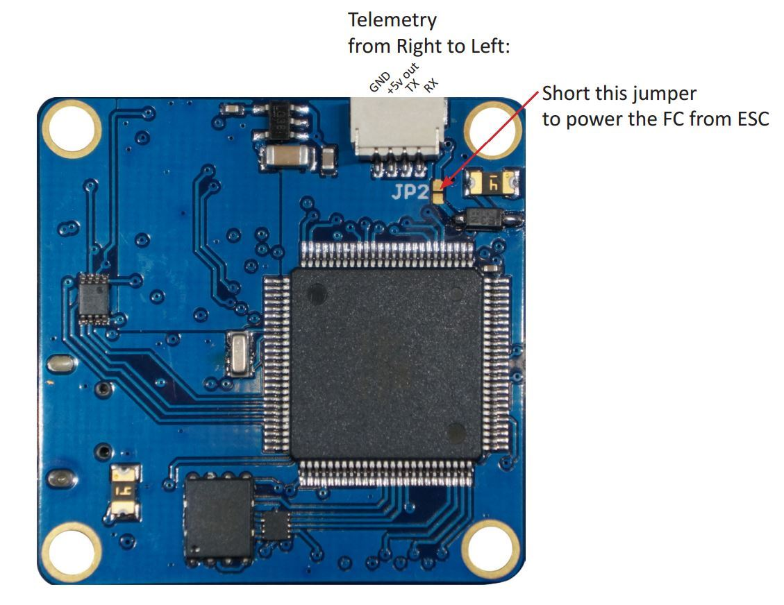

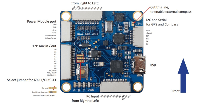

We have a picture showing the pin-outs of the mini APM v3.1 on our shop website. However I have also included the image in my reply ![]()
Hope that helps
Thanks for the information provided but I need to know the connector names, are they Jst’s or some other “” connector. I want to build custom wire lengths and I need to buy the crimp pins that go into the plug connectors.
Capt Den
I believe they are 1.25mm Molex connectors, but I dont have one with me right now to confirm.
