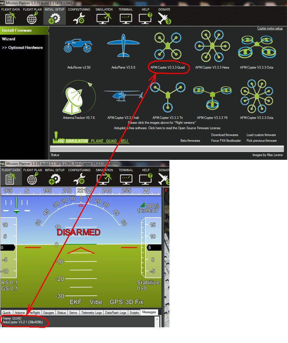

OK, now that’s become more clear. When I updated the firmware it said downloading 3.3.3, but on the flight data page (at the bottom) it said 3.2.1. (See attached pic)

The issue is that the new ESC calibration process in mission planner is not compatible with APM 2.6 because you can’t install the latest firmware onto APM boards. That’s also the reason why there is no CLI on the APM anymore as there is not enough memory. You can however change the parameters by viewing the full parameter list on the config/tuning tab to disable the disarm timer if you want. But in my experience it’s easy enough to just to re-arm it as you don’t want it to accidentally turn motors on when you are about to disconnect the battery if you bump your r/c sticks.
