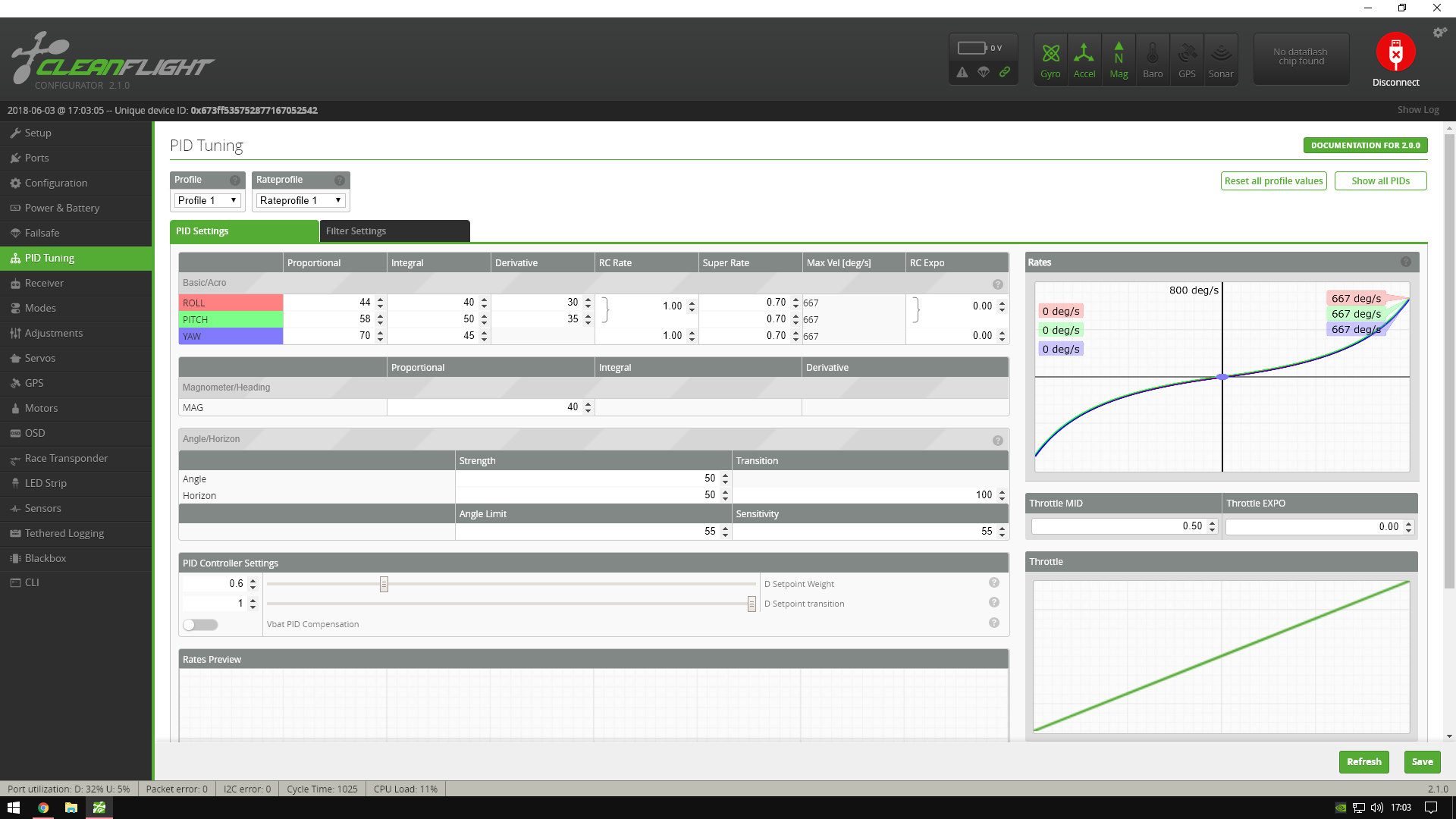

How to select which PID controller i would like to use on cleanflight?

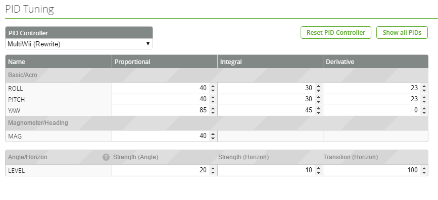

This was a screenshot taking from an older version of cleanflight were i was able to choose between the different controllers, I want to use LuxFloat with my Naze32 but on the new version there are no options to change this???
