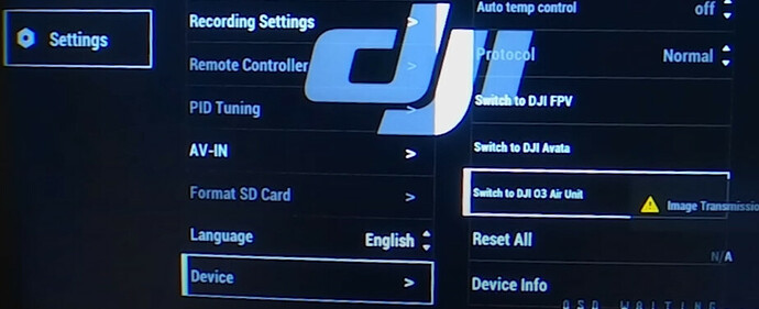

  1. Go to Settings => Device => Switch to DJI FPV in the goggles’ menu, then power cycle the goggles.

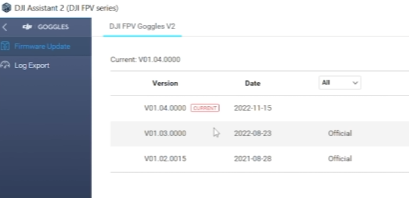

  2. Connect your V2 goggles to your computer, open up the DJI Assistant 2 (DJI FPV Series) app, and update to the latest firmware. This is important. Its also worth noting if you have done the wtf.fpv root hack of your goggles and you run into binding issues, please see this guide -
  3. Go to the menu, Settings => About => Switch Aircraft Model => DJI O3 Air Unit.
