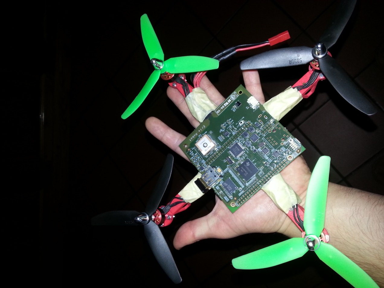

Hi everyone,
I’d like to introduce another quadcopter, Erle. We’ve been working for about a year to create a drone that wears Linux and some of the most popular frameworks for robotics such as ROS and KnowRob:
We just finished up assembling this prototype and built a test bed and in the following weeks we hope to start trying several control algorithms.
More information at http://erlerobot.com. We will be happy to hear your feedback

Are you using an operating system or is it custom firmware?
Hi! We are using Linux OS. We work with Debian and a Ubuntu File Systems. Real time is an issue so we’re testing the kernel RT patch and Xenomai.
You also might want to look at the ardupilot/arducopter project because its currently being ported over to beaglebone black so might be of some help to you. I dont think its officially released right now but its still in working state I believe.
I was wondering about the real-time response with a non-RT OS. Would be great to see this working, can imagine the more powerful algorithms that can be used to help stabilise the craft or add more complex processing to deal with avoidance of other craft etc
Hi guys! Thanks for your comments. I’m actually pushing with the port of ArduPilot to the BB(B) ;). For informative purposes, there’s also a couple of other promising initiatives, i personally like LinuxDrone where they are working on top of Xenomai. Their code is pretty nice, clear and well structured.
For now on Erle we are testing the capabilities with simple python scripts (no RT yet) but we have plans to embed both ArduPilot (on Linux) and LinuxDrone.
