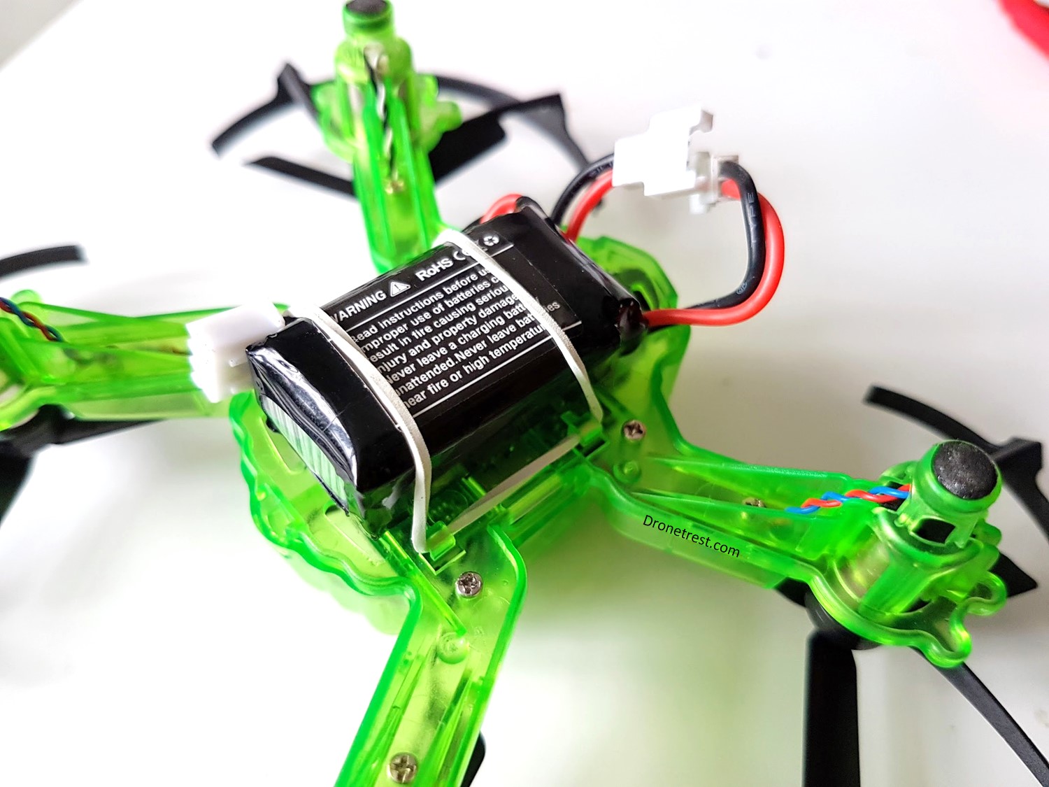

It is definitely getting a few extra batteries, as each one will only last for about 5 minutes of flying. So unless you want your fun to end early.. grab a bunch of extra batteries with your order so you can fly a few battery packs one after another. The battery itself is neatly attached via some velcro and elastic band underneath the quad, making it easy to change, whilst still being secure.

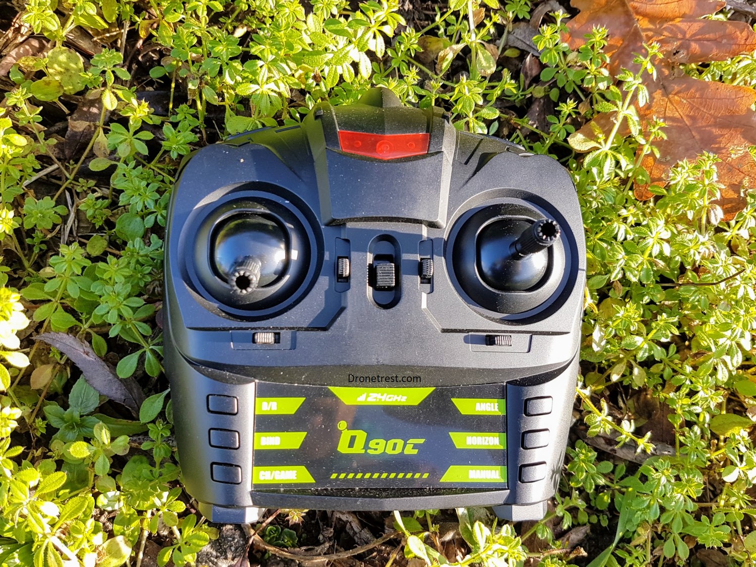

The Remote Control
The included remote does not exactly scream quality, but for the purpose and price, it is great for any beginner to FPV flying. The toy grade remote does its job and has buttons to change to one of three flight modes via dedicated buttons. When you change flight mode, the vibration feedback lets you know it has changed which is great. The three flight modes:
  • Angle Mode: Self-level the quad and not let your quad tilt past 45 degrees (great for learning to fly)
  • Horizon Mode: Self-level the quad, but lets you perform flips (intermediate)
  • Acro Mode: Full manual mode, when you get good
It also includes 3 rates that you can switch between using the D/R button. This essentially changes the sensitivity of the quadcopter with the first mode being very sluggish that is great for beginners. As you change between the rates you get quick burst of vibration from the controller, with a single buzz being for the beginner mode and 3 buzzes for the most sensitive setting. The only thing that I found annoying here, is that by default it is always in the first rate, so you need to change it before each flight.
Wireless (kind of) Simulator Mode
The simulator mode further makes this quad ideal for people wanting to dip their feet into the FPV world. This lets you use the R/C controller with FPV simulator games like DRL simulator (free), or FPV freerider (paid) which is a great way to practice new tricks without destroying your drone in a crash.
The way this works is that you plug your flying frog into your PC, and press and hold the game mode button. This lets you use the remote wirelessly to practice your favourite FPV simulator when it is raining outside, or waiting for your batteries to charge! This added feature secures the Q90C as an excellent beginner FPV quadcopter.
Just remember when you are done with game mode, you need to press and hold the button again for 3 seconds so it will go back into normal mode. The radio will vibrate when it changes mode.
